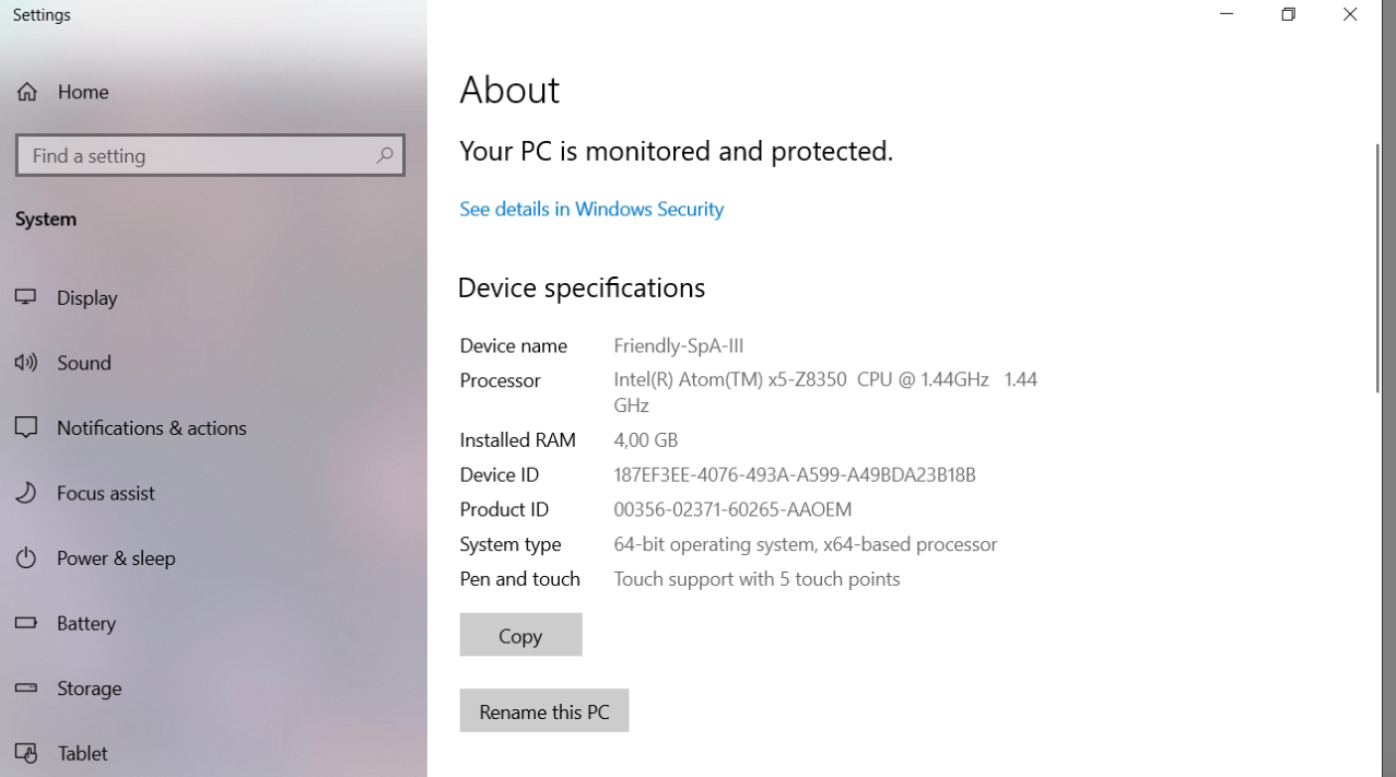

Hello, I have a Windows 10 PC with certain name according to this image:
well... I have installed SQL Server 2019, but strangely, the hostname is different. That causes an error when authenticating user:

    I think the problem lies in that Friendly-SpA-III is 16 letters, and NETBIOS names are restricted to 15 letters.
    So I would recommend that you rename the computer. Once you have renamed it, check SELECT @@servername to see what it returns, then do:
       EXEC sp_dropserver <oldserverame>
       EXEC sp_addserver 'NewName', 'local'
    Also check sys.server_principals for logins with the old name and use ALTER LOGIN to fix those.
    If you rename the machine to Friendly-SpA-II, you may not have to do very much.

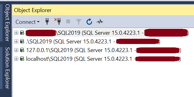

    Following Erland's answer, here is the document regarding Rename a Computer that Hosts a Stand-Alone Instance of SQL Server
    If you do not want to change the Computer name and you are connecting it locally, then instead of connecting using the machine name "Friendly-SpA-III\Instance_Name" you can sue any of the following solution to connect the SQL Server
    Option 1: you can try to use dot ".\Instance_Name"
    Option 2: You can try to use internal loop IP for the localhost which is usually 127.0.0.1 so you can use "127.0.0.1\Instance_Name"
    Option 3: You can use the word localhost "localhost\Instance_Name". The localhost word is the default name describing the local computer address also known as the loopback address.
    As you can see in the following image you can use all the above options to connect the local server
    Note: If your server is the default instance and you do not want to use the instance name then do the same without instance name
