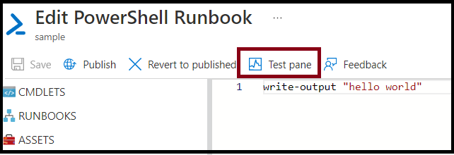

    3. An efficient way to test the runbook in Azure Automation would be to use the write-output to print debug logs and using the Test pane in Azure portal when editing the runbook as shown below. This would help you get immediate feedback on the script run in Azure Automation along with the capability to edit it to solve the issue.
