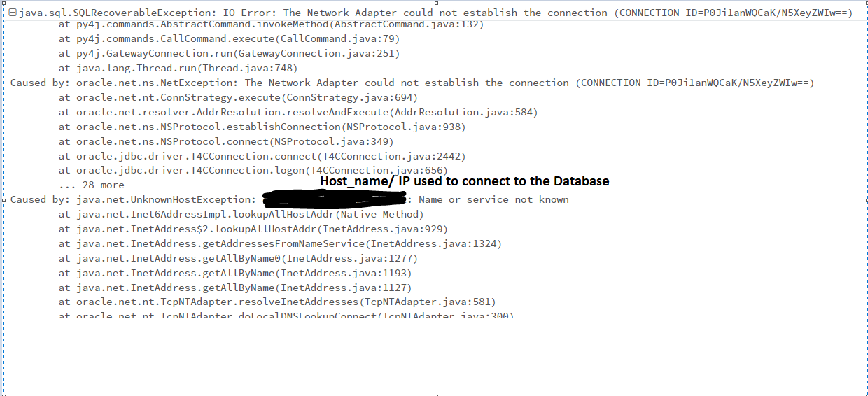

Next, I tried to connect using Pyspark and it also failed with below error. Also installed OJDBC into the cluster, where I used OJDBC version compatible with Oracle DB version.
URL =  "jdbc:oracle:thin:" + User_Name + "/" + Password + "@//" + IP + ":" + Port + "/" + DB_name
DbTable = DataBase_name + "." + Table_Name
Table_data = spark.read.format("jdbc").option("url", URL).option("dbtable", DbTable).option("user", User_Name).option("password", Password).option("driver", "oracle.jdbc.driver.OracleDriver").load()

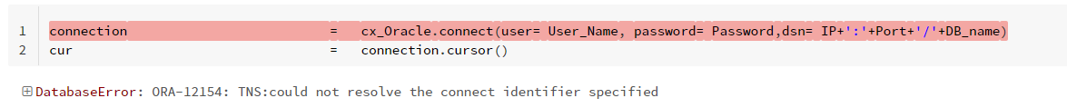

I even tried the new library for cx_Oracle --> oracledb, still the same issue,
without_config, with config_dir (I guess the path is different in databricks), with conn string, Creating DNS, Connect Descriptor string
Can you advise why the connection is not working in Databricks for the same settings as in ADF?

  1. PRADEEPCHEEKATLA 90,641 Reputation points Moderator
    2022-06-16T09:40:21.913+00:00
    Hello @Manoj Ashvin ,
    Thanks for the question and using MS Q&A platform.
    Make sure to whitelist Databricks workspace VNet on Oracle firewall.
    For more details, refer to the SO thread addressing similar issue.
