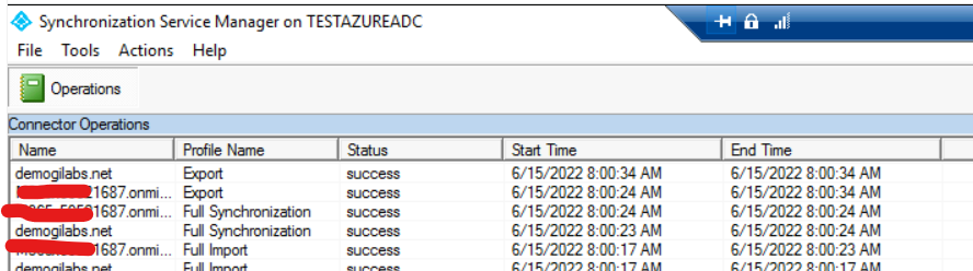

    You can add the desired account to ADSyncOperators groups and launch miisclient.exe to view the stats/errors which are occurred during sync cycle.
    However you can run the sync cycle initial/delta via PowerShell or you can right click connector run the operation (full/delta - Import/Sync and export ) below is how Sync service UI looks when user is part of ADSyncOperators Group.

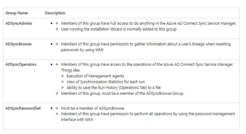

    These four(4) Security Groups are installed by default when executing the installation of Azure AD Connect, these will be installed locally on the Azure AD Connect Server. You will find them in Local Users and Groups.
    ADSyncAdmins, ADSyncBrowse, ADSyncOperators, ADSyncPasswordSet
    Reference: https://learn.microsoft.com/en-us/archive/blogs/iamsupport/support-info-azure-ad-connect-sync-security-groups
