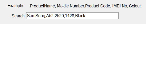

I am going to create a search function where the texts in the textbox act as endings With and conditions.
If I use the OR condition, the function works fine but I don't understand how to use the And.
For example, I want to type in a text box - then product code, then product name, then product category, then brand name.
From where it will be possible to find Single row.
I would have benefited if an experienced person had wasted his precious time and cooperated in the solution. Thanks
Thanks in advance to the experienced collaborators.

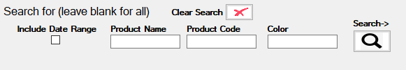

    Ok, as noted, we need to build a UI here, and one that allows:
    Maybe a date range, maybe not.
    Enter color - we get all products of that color
    enter Brand, get all product of that brand.
    Enter Brand, such as SamsSung, and enter color Black - we get all black SamsSung.
    enter Brand, enter color, enter date range. We get all that color, for product - and within the given date range.
    As we can see, we need the search criteria as "optional", and if we just enter black for color, we get all products.
    As I stated, most search works above anyway. So, if we leave whatever search option "empty", then we ignore it. If user enters a value(s), then we AND the criteria. So, SamSung, or SamSung AND Black color.
    As I pointed out in the other answer - the "design" pattern and approach works very well for this kind of setup. we can have 1, or 15 search options - the CODE remains the same!!!!
    So, lets assume we have this search:
    One BIG whopper issue is that date pickers don't allow blank values. So, you can waste a few pots of coffee, but best is to simple offer the user a check box WHEN you want to include date range.
    Now, I don't have all your text boxes, but the form would in theory would, and could look like this:
    To above, you can add a few more text boxes for the other searching you want. As noted, for date range, we can't have blank date pickers, so with above, we have a simple check box. (just drop the 2 date pick controls into a panel, and we can hide/show the panel when we check the check box like this:

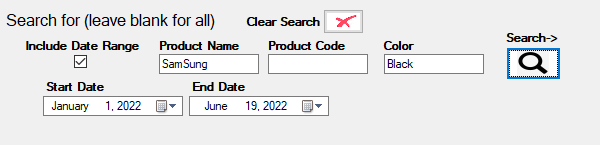

    so, if I check the check box, and wanted SamSung, and black - and for this year up to today, then we have this:
    The key concept, the Rosetta stone, the gold bar here is that we are now to free to use my other answer here as to how we attack and solve this problem. Each blank search text box, we SIMPLE ignore!!!
    So, now lets use the code concept in the other answer, and code this out:
    Based on first answer, then our code becomes "much like" this (this is air code - I don't have your code, your data, and your system - so I have to wing this a bit, but this is about the approach and attack of this kind of problem).
    So, the code will look very much like this - you can extend for your purpose:
