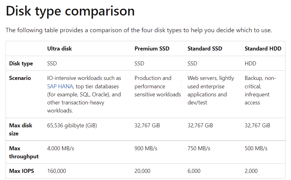

    w.r.t 2) Disk speeds depends on the type of disk like Standard SSD , Premium SSD , etc.
    https://learn.microsoft.com/en-us/azure/virtual-machines/disks-types
    Disk type comparison
    https://learn.microsoft.com/en-us/azure/virtual-machines/disks-types#disk-type-comparison
    The following table provides a comparison of the four disk types to help you decide which to use.

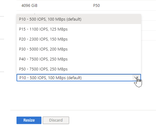

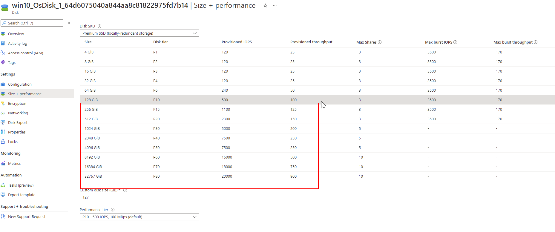

  1. shiva patpi 13,376 Reputation points Microsoft Employee Moderator
    2022-06-22T03:55:20.363+00:00
    You can change the Disk Size + Performance from the Azure Portal, Please see the below screen shots:
    You can choose the required MBPS (default is 100 MBPS)
