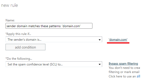

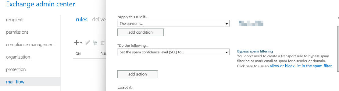

  1. KyleXu-MSFT 26,396 Reputation points
    2022-06-20T04:57:57.033+00:00
    @lalajee
    Have a check about those messages, check whether SCL in message header is high.
    A quick solution is to create transport rules for those senders to bypass spam filter on Exchange on-premises and Exchange online:
    In this way, emails sent from them will not be judged to be spam by Exchange server.
