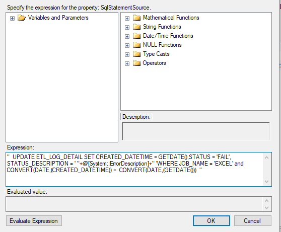

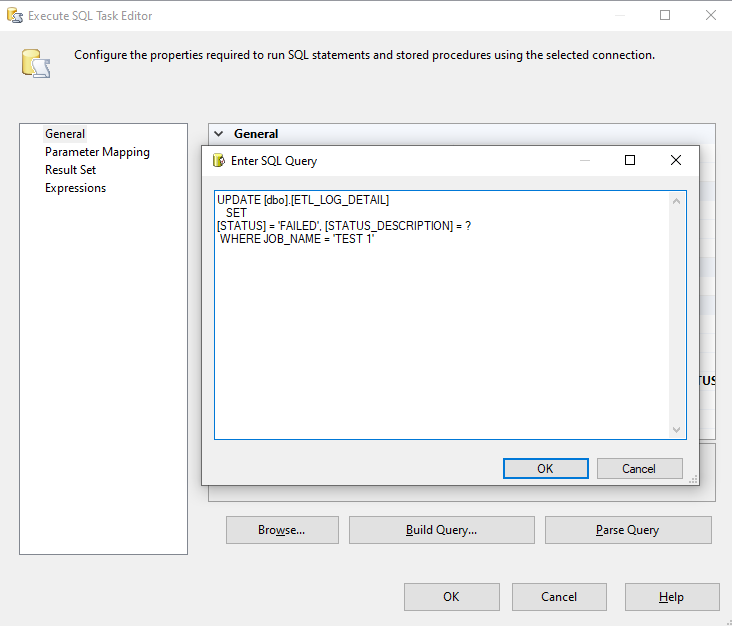

Hi Everyone,
I have import excel files and I want to update my custom error log table using error description from SSIS
i try to use event handler and put it in OnError. it does update the other column but not the status_description which i set to get error messages. Below is my script, im using sqlstatementsource and SQL Statetment but both of them does not give the error messages.
Can anyone give me insight?
Thanks

  1. ZoeHui-MSFT 41,491 Reputation points
    2022-06-23T03:15:28.793+00:00
    Hi @Ivan Raditya ,
    Click the parameter mapping in the left column and add each paramter from your command and map it to your SSIS variable.
    Make sure that you map them correctly.
    Refer to execute-sql-task about the mapping.
