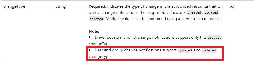

Hi @Oscar Cedano , please try changing the value of chageType to updated. As the documentation mentioned, User change notification supported updated and deleted.

    This worked. Thank you! Oddly, enough. I set up a webhook for both updated and deleted actions, and deleted actions seem to be coming in with the changeType property set to updated, instead of deleted.
    Also, looks like the change notification doesn't include what fields were updated unfortunately, but I think that's by design.
    Regardless, thanks for pointing this out.
