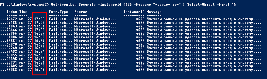

Here wo go. I can't find solution and need help. Problems started when a user changed his password on a new. On my DC i have 4625 event every 1 minute in Security log and user account is blocking. I get from it ip-source from whom attempts to logon are going. But its show me on server from another domain! I check all services, schedules, programms but i can't figure out who use wrong creds. I tried netlogon logging, procmon and process explorer, but i can't find out root of problem. Also 4625 have one strange thing - Workstation name show me name of the DC itself, while ip-source show me on the other server on another domain. I turned off 10.0.5.159 on 10 minutes and new events are stopped! But when i get it online - events starts appear again. I don't know how to locate process that used these wrong creds.
4625 Event from DC
Blocked account:
Account name: pavlov_aa
Account domain: AKRONPLUS
Info about error:
Reason: %%2313
Status: 0xc000006d
Substatus: 0xc000006a
Info about process:
Process ID: 0x280
Name process: C:\Windows\System32\lsass.exe
Network info:
Workstation name: DMS-DC01
Ip source: 10.0.5.159
Port source: 4733

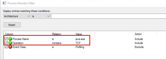

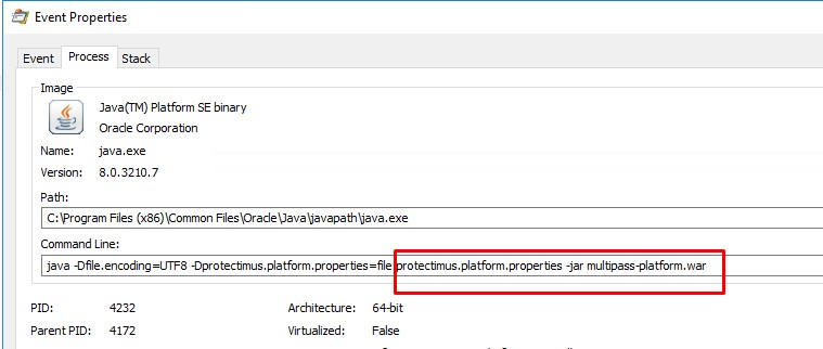

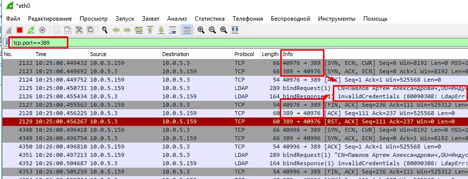

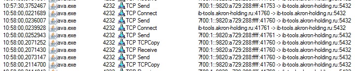

    Thank you my friend for advice. I find the reason:
    1. I run on my server portable Wireshark with filter "tcp.port==389" - it's LDAP port on which a process send wrong creds. But to find this filter i start from "ip.dst==My_DC_IP" and find out that on my DC on 389 port arriving wrong creds.
    2. I get range of ports from 418XX-419XX, ports changes every time, but i get a range. Also i have pretty cool timestamp - every 1 minute process try to send wrong creds on my DC.
    3. I launch Procmon (with admin privs) from SysInternalSuite with filters for "java.exe" (i suspected it) adn what the most crucial "Operation contains TCP" to get rid off from non-network events
    4. I get a list network activity for Java and timestamps and ports range perfectly fit with what Wireshark showing me.
    1. I watch properties of Java process in Procmon and in commandline i see the culprit - Protectimus. Old, pilot project with trial licnese for 2FA. It was installed 1 year ago.
      1. I delete it and all problems are gone.
    Old, abandoned programm with trial-license all the time try to establish connection with AD use wrong creds. 4625 Security event on my DC give me the ip-source of troublesome guy, but to find the process i need to start wireshark and procmon to find the reason.

    Thank you my friend for help. I find the reason:
    1. I run on my server portable Wireshark with filter "tcp.port==389" because LDAP use this port and all connections with wrong password try to send them on this port.
    2. It give me a range of source ports that connected to 389. From 417XX to 418XX. Source port changes every time, but i get a narrow range.
    3. I start "Procmon" (with admins privs) from SysInternalSuite to get history of processes actions
    4. In Procmon i use filter for "Java.exe" (because i suspected it) and what the most crucial for "Operation contains TCP" to get rid off from other not network stuff
    5. I get a list of network activity fo java
    6. Activity of Java perfectly fit to time where Wireshark see ldap with wrong creds. Also source ports fits in range.
    7. I watch Properties of Java process in Procmon and in commandline sections i saw the culprit. Protectimus - programm for 2FA that was installed on this server 1 year ago as pilot project and was abandoned. I delete this guy and all problems are gone.
    Old abandoned programm with expired trial-license made me start 1 week of searches what blocking user account. 4625 event in my DC give me ip-source of troublesome guy. But to find who send wrong creds i need to launch portable wireshark and start process activity monitoring.
