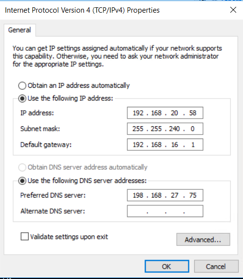

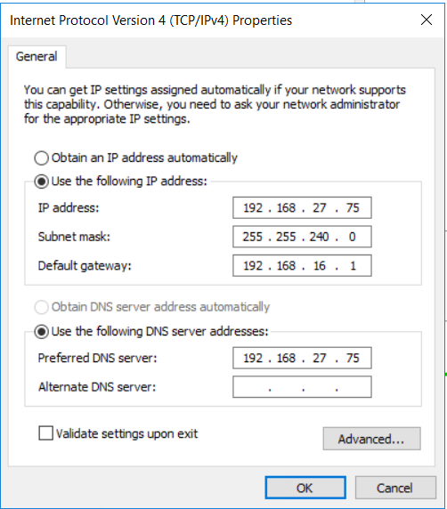

    Hi, the servers are connected to the router of my home network. They received the IPs automatically. This is what I did:
    1. run ipconfig /all on VM1 and copy the ip received by the DHCP server, the subnetmask mask and the default gateway (my router's IP)
    2. go to "Control Panel\Network\Sharing Center then Change adapter settings\Properties", choose "Use the following IP address."
      3.fill in the fields using the above information (I used the the IP address of the VM1 for the DNS server)
    I repeat the above steps on VM2. The only difference is that I used VM1`s IP address for the DNS server instead of its IP address. Then I crossed my fingers and run the wizard again. Unfortunately, the problem is still here.

    C:\Users\Administrator> ipconfig /all
    Windows IP Configuration
    Host Name . . . . . . . . . . . . : DC-1
    Primary Dns Suffix . . . . . . . : landonhotel.local
    Node Type . . . . . . . . . . . . : Mixed
    IP Routing Enabled. . . . . . . . : No
    WINS Proxy Enabled. . . . . . . . : No
    DNS Suffix Search List. . . . . . : landonhotel.local
    Ethernet adapter Ethernet:
    Connection-specific DNS Suffix . :
    Description . . . . . . . . . . . : Microsoft Hyper-V Network Adapter
    Physical Address. . . . . . . . . : 00-15-5D-01-04-03
    DHCP Enabled. . . . . . . . . . . : No
    Autoconfiguration Enabled . . . . : Yes
    Link-local IPv6 Address . . . . . : fe80::d16d:2ba5:baa8:1262%13(Preferred)
    IPv4 Address. . . . . . . . . . . : 192.168.27.75(Preferred)
    Subnet Mask . . . . . . . . . . . : 255.255.240.0
    Default Gateway . . . . . . . . . : 192.168.16.1
    DHCPv6 IAID . . . . . . . . . . . : 50337117
    DHCPv6 Client DUID. . . . . . . . : 00-01-00-01-2A-4B-55-AB-00-15-5D-01-04-03
    DNS Servers . . . . . . . . . . . : ::1
    192.168.27.75
    NetBIOS over Tcpip. . . . . . . . : Enabled

    215778-vm2-tcp-ip-properties.png215831-vm1.pngVM2#####
    Host Name . . . . . . . . . . . . : DC-2
    Physical Address. . . . . . . . . : 00-15-5D-01-04-02
    Link-local IPv6 Address . . . . . : fe80::70be:af80:d03f:c015%12(Preferred)
    IPv4 Address. . . . . . . . . . . : 192.168.20.58(Preferred)
    DHCPv6 Client DUID. . . . . . . . : 00-01-00-01-2A-47-9D-35-00-15-5D-01-04-02
    DNS Servers . . . . . . . . . . . : 198.168.27.75

    2022-06-28T15:13:53.94+00:00
    A class C mask (255.255.255.0) should be fine on all members. I'd probably address them all on 192.168.16.xxx network assuming the router is 192.168.16.1
