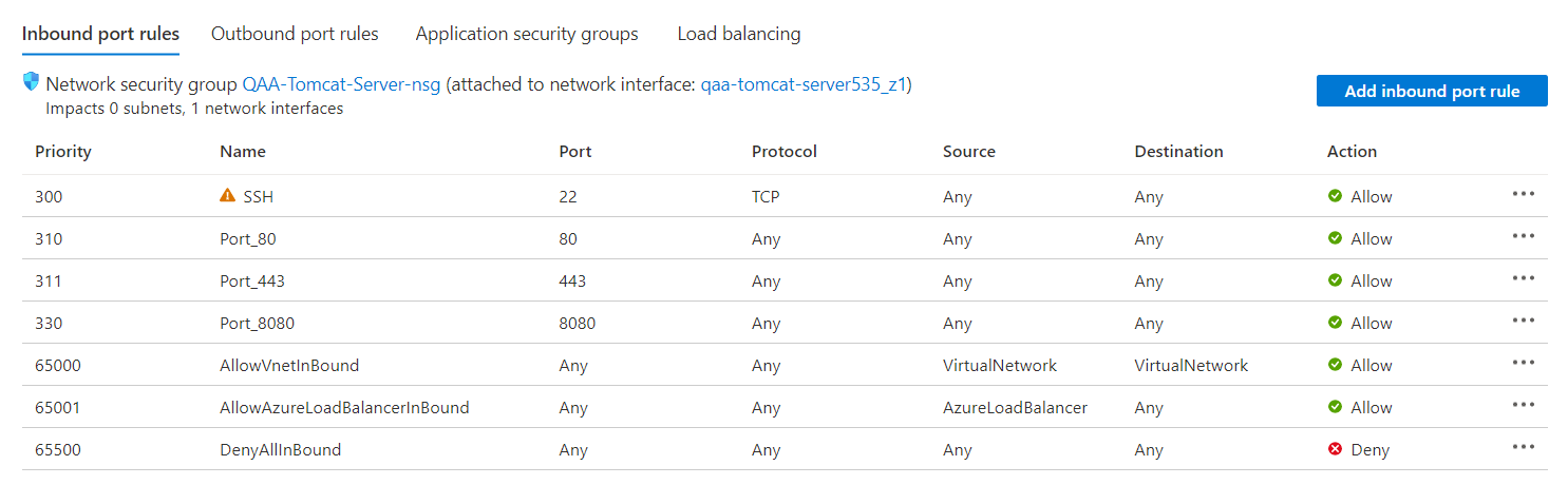

I am new to azure and I created a Redhat Linux machine and I installed tomcat on it. I changed port from 8080 to 80, tomcat is working fine and I changed port perfectly. I enabled ports 22,80,443 in NSG, except 22 other ports are not working. I don't know what the reason is.
This is my NSG setup

  1. Manu Philip 20,211 Reputation points MVP Volunteer Moderator
    2022-06-29T03:34:23.073+00:00
    I guess, the local firewall ports are blocking for a public access.
    I assume that you are using RHEL 7 or above
    Check, if the firewall is active by the command: firewall-cmd --state
    To add the port 80 in exclusion list, you may use the commands:
    sudo firewall-cmd --zone=public --add-port=80/tcp --permanent
    sudo firewall-cmd --reload
    firewall-cmd --list-all
