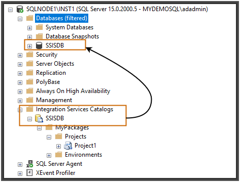

  1. Yitzhak Khabinsky 26,586 Reputation points
    2022-07-01T14:27:37.747+00:00
    Hi @Eugen Buss ,
    It would be better to start using Integration Services Catalog and SSISDB.
    They are available starting from SQL Server 2012 onwards.
    creating-the-ssis-catalog
    introduction-to-the-ssis-catalog-database-ssisdb
