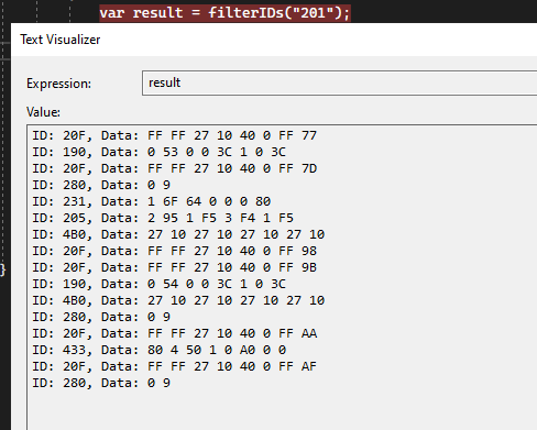

    @Charlie Gale , Welcome to Microsoft Q&A, have you considered another method without using Regex? It may be more simpler.
    Please refer to the following code to use linq to remove a line which contains the certain value.
     static void Main(string[] args)
                var result = filterIDs("201");
            public static string filterIDs(string dataIn)
                var filteredIDs = File.ReadAllLines("1.txt");
                var notincluded = filteredIDs.Where(x => !x.Contains(dataIn));
                string result=string.Join("\r", notincluded.ToArray());
                return result;
    Note: Here I used txt file as the data source and you could make some changes based on your situation.
    Tested result:
    Hope this could help you.
