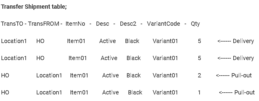

Good day!
Need help re SUM and JOIN 2 columns with different tables but did not SUM qty and duplicates row result
here's the sample data tables;
here's my updated sql query code;

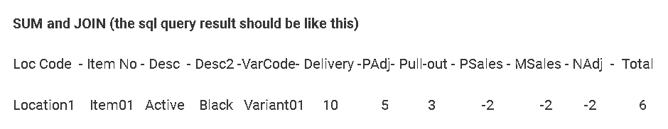

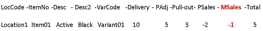

but the sql query did not sum qty of MSales column;
query issues;
  • MSales column;
    • did not sum qty, but did not duplicate result
if i remove the WHERE filter ST.[Item No], ST.[Variant Code] to show all the ITEMS and VARIANT from LOCATION01
the query results shows only all ITEMS and VARIANT with MSales entry and PAdj entry, it should show all ITEMS and VARIANT even if there is no MSales entry and PAdj entry
Thank you

  1. MelissaMa-MSFT 24,221 Reputation points
    2020-09-11T02:46:20.603+00:00
    Hi @glennyboy ,
    Please have a try to replace last part with below:
    ,CTE AS (
     SELECT  DISTINCT   ST.[Location],
              ST.[Item No],
              ST.[Description],
              ST.[Description 2],
             ST.[Variant Code],
             ST.[Delivery],
             ISNULL(PADJ.[Quantity],0) AS [PAdj],
             ISNULL(TF.[Pull-out],0) AS [Pull-out],
             ISNULL(SS.[Sales Entry],0) AS [PSales],
             ISNULL(MS.[Quantity],0) AS [MSales]
     FROM [SumarisedTransfers] ST
     LEFT JOIN [Transfersfrom] TF
     ON [ST].[Location] = [TF].[Locationfrom]
     AND [ST].[Item No] = [TF].[Item No_]
     AND [ST].[Variant Code] = [TF].[Variant Code]
     LEFT JOIN [SumarisedSales] SS
     ON [SS].[Store No_] = [ST].[Location]
     AND [SS].[Item No_] = [ST].[Item No]
     AND [SS].[Variant Code] = [ST].[Variant Code]
     LEFT JOIN [BBI$Item Ledger Entry] MS
     ON [ST].[Location] = [MS].[Location Code]
     AND [ST].[Item No] = [MS].[Item No_]
     AND [ST].[Variant Code] = [MS].[Variant Code]
     LEFT JOIN [BBI$Item Ledger Entry] PADJ
     ON [ST].[Location] = [PADJ].[Location Code]
     AND [ST].[Item No] = [PADJ].[Item No_]
     AND [ST].[Variant Code] = [PADJ].[Variant Code]
     WHERE
     ST.[Location]='LOCATION1' AND
     ST.[Item No]='ITEM01' AND
     ST.[Variant Code]='VARIANT01' AND
     MS.[Entry Type]='1' AND
     MS.[Document No_] LIKE 'MSales%' AND
     PADJ.[Entry Type]='2')
     ,CTE1 AS(
     SELECT Location,[Item No],Description,[Description 2],[Variant Code],Delivery,
     SUM(PAdj) PAdj,[Pull-out],PSales,MSales
     FROM CTE
     GROUP BY Location,[Item No],Description,[Description 2],[Variant Code],Delivery,[Pull-out],PSales,MSales )
     SELECT *,[Delivery]+[PAdj]-[Pull-out]+PSales+[MSales] AS Total
     FROM CTE1
    Best regards
    Melissa

    Output:
    Location	Item No	Description	Description 2	Variant Code	Delivery	PAdj	Pull-out	PSales	MSales	Total
    Location1	Item01	Active	Black	Variant01	10	5	3	-2	-2	8

          ,CTE AS (
                    ST.[Item No],
                    ST.[Description],
                    ST.[Description 2],
                   ST.[Variant Code],
                   ST.[Delivery],
           LEFT JOIN [BBI$Item Ledger Entry] NADJ
           ON [ST].[Location] = [NADJ].[Location Code]
           AND [ST].[Item No] = [NADJ].[Item No_]
           AND [ST].[Variant Code] = [NADJ].[Variant Code]
           WHERE
           ,CTE1 AS(
           SUM(PAdj) PAdj,[Pull-out],  PSales ,SUM(MSales) MSales
           FROM CTE
           GROUP BY Location,[Item No],Description,[Description 2],[Variant Code],Delivery,[Pull-out],PSales )
           FROM CTE1
    Best regards
