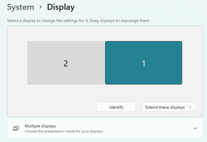

I have an odd issue when I run with a particular monitor configuration and I use the per monitor DPI awareness context for my app. First here is my current configuration when I open the Display settings.
Monitor 2 Monitor 3 Monitor 1
Monitor 2 is a 1680x1050 resolution, DPI is 100%, landscape and I have Extend desktop to this display.
Monitor 3 is a 3840 x 2160 resolution, DPI is 200%, landscape and is my main display.
Monitor 1 is a 1920x1080 resolution, DPI is 100%, landscape and I have Extend desktop to this display.
