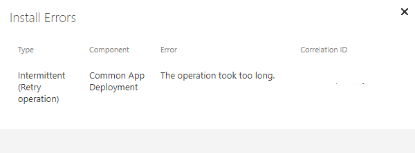

I am currently using MSOnline Powershell module (New-MsolServicePrincipal) to register an app, so SharePoint Add-in can be added and installed on the tenant afterwards. This mimics app registration through AppRegNew. aspx. Since MSOnline module is getting deprecated, and ServicePrincipalType that is getting created is Legacy, I am trying to use other modules to register an app. Currently I am using Azure Az module (New-AzADApplication and New-AzADServicePrincipal) to create an App Registration and Service Principal associated with it.

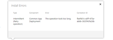

The issue I have now is that when I am trying to install SharePoint Add-in, installation fails with the ‘The operation took too long.’ error:
Creating app registration together with service principal manually through Azure AD gives the same result, but if creating it through AppRegNew .aspx everything works properly. If someone has encountered this before or knows what the issue might be I would appreciate any help.

    Hi @fredj-6392
    Per my test, I will get the same error register app with Service Principal and it fixed with the app registered in AppRegNew .aspx.
    After research some document. I will recommend to create it through AppRegNew .aspx like following document
    https://learn.microsoft.com/en-us/sharepoint/dev/sp-add-ins/register-sharepoint-add-ins
