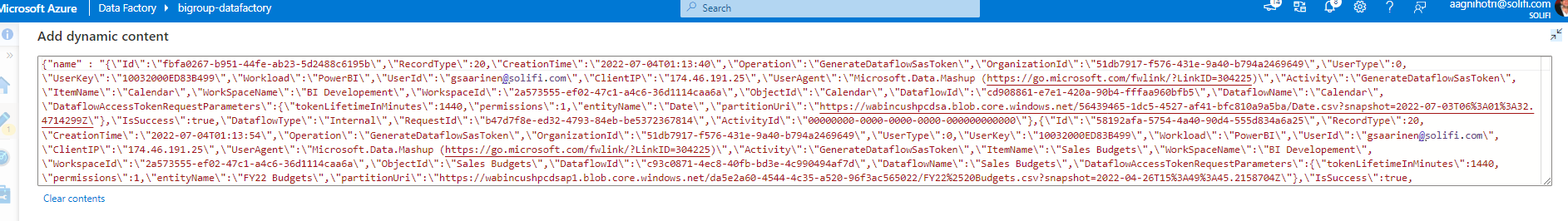

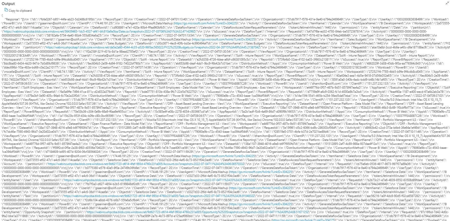

"Change Array To String" activity is holding an output in Data2 variable as shown

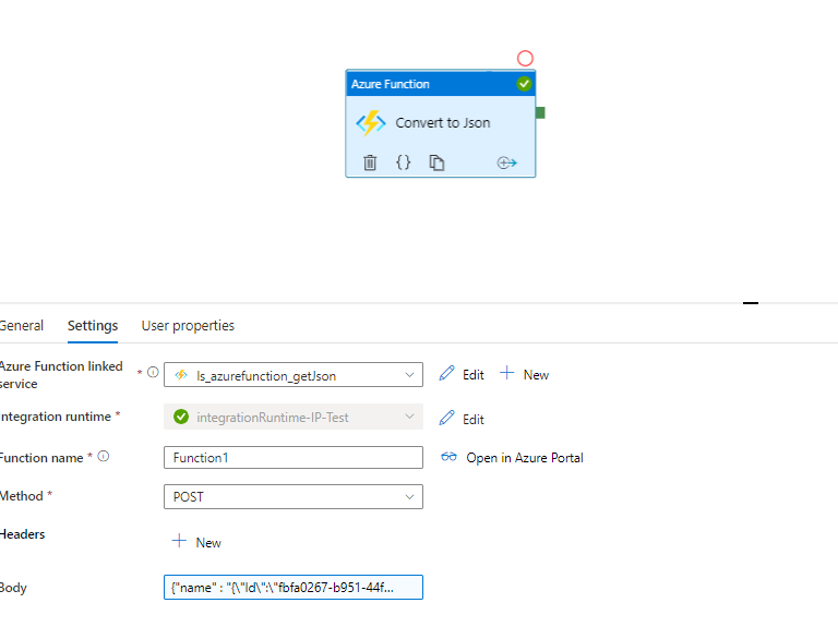

Now i want to pass this value of Data2 varibale to name variable in azure function . I tried this in azure function activity

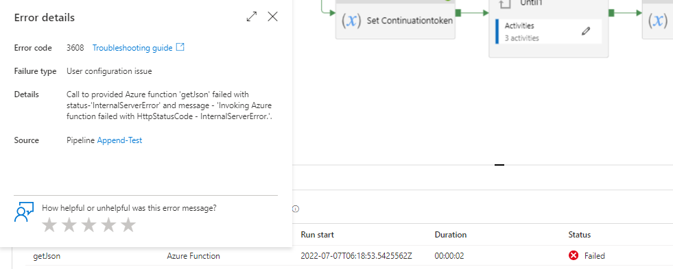

But My function is not able to run showing the below error -
Can anyone suggest something to resolve this ?

    Thank you for the ask. Function Body seems incorrect. It should be a valid JSON. Would you please try something like:
    "name": "@{variables('Data2')}"

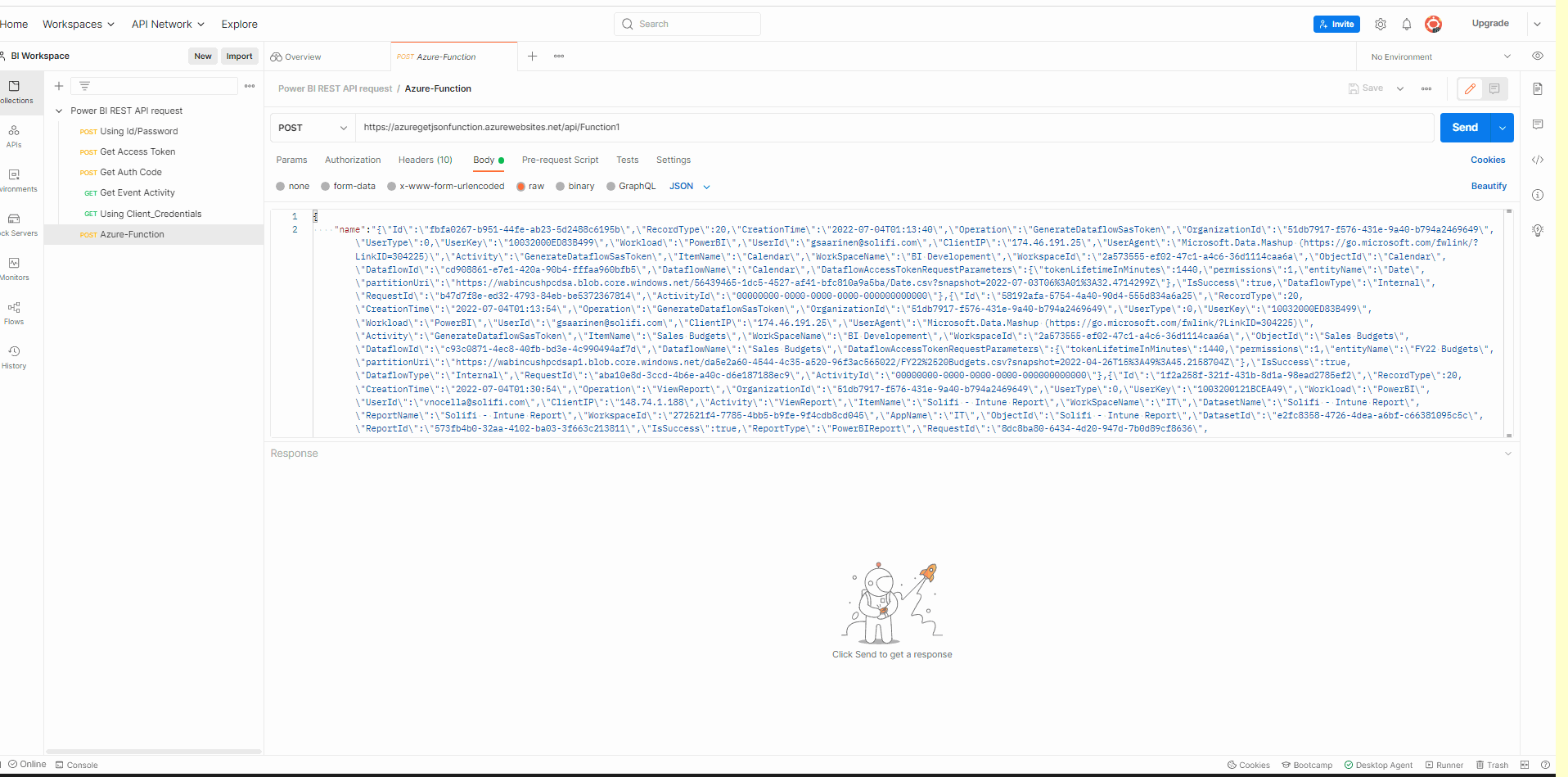

    Thanks for the reply. Let me show you where am i stuck at right now -
    I create my azure function in Visual studio and published it to azure. The function is taking string and converting it to the json format .

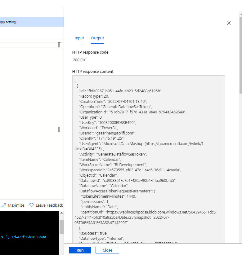

    This is the input string to the function -

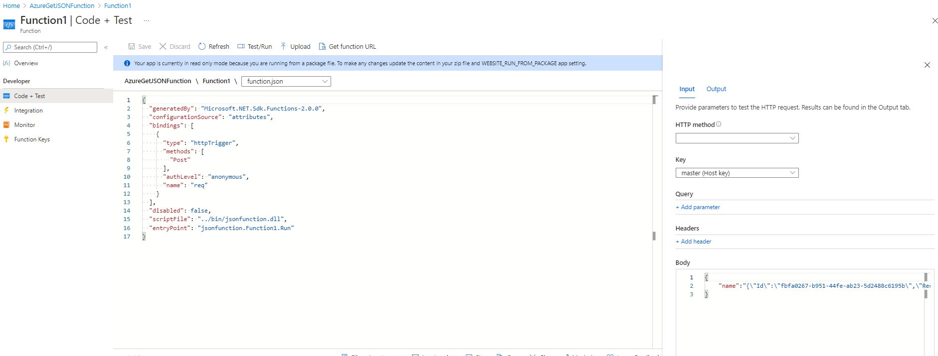

    I put this input to check azure function in portal
    and this is the output of azure function which is a valid json format
    I checked this function in Postman too and it is working fine. You can see i checked the output in jsonlint.com for the valid format and we are getting what we want

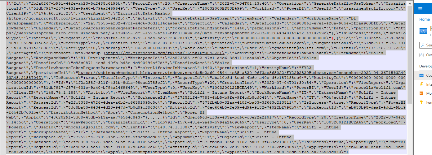

    In both the azure portal and postman my function is working fine but when i checked this in adf pipeline in azure function activity it is not working it is returning the same input string . I believe it is not getting the value for the name . You can see that the function is being called -
    but it is not returning the valid output
    I am not able to understand why it is not working fine in function activity in adf. You can see that i passed the hard coded value in the body in the same way as i did in azure portal and postman -
    Am i doing any mistake in the body section to pass the value for the name variable of function ?

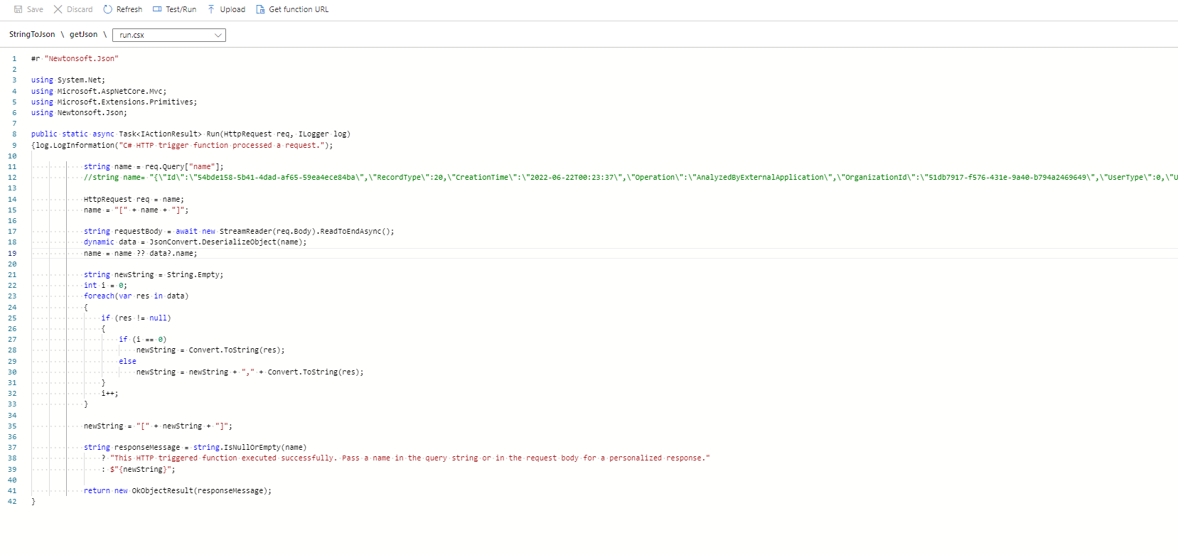

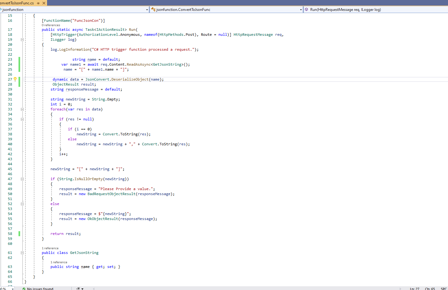

    This is my azure function code -
    Can you please tell me what i am doing wrong while making a call in adf.
