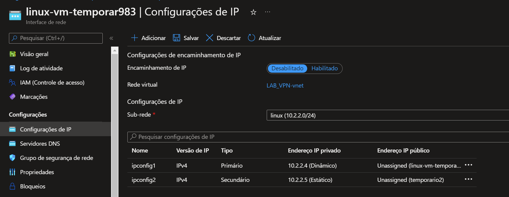

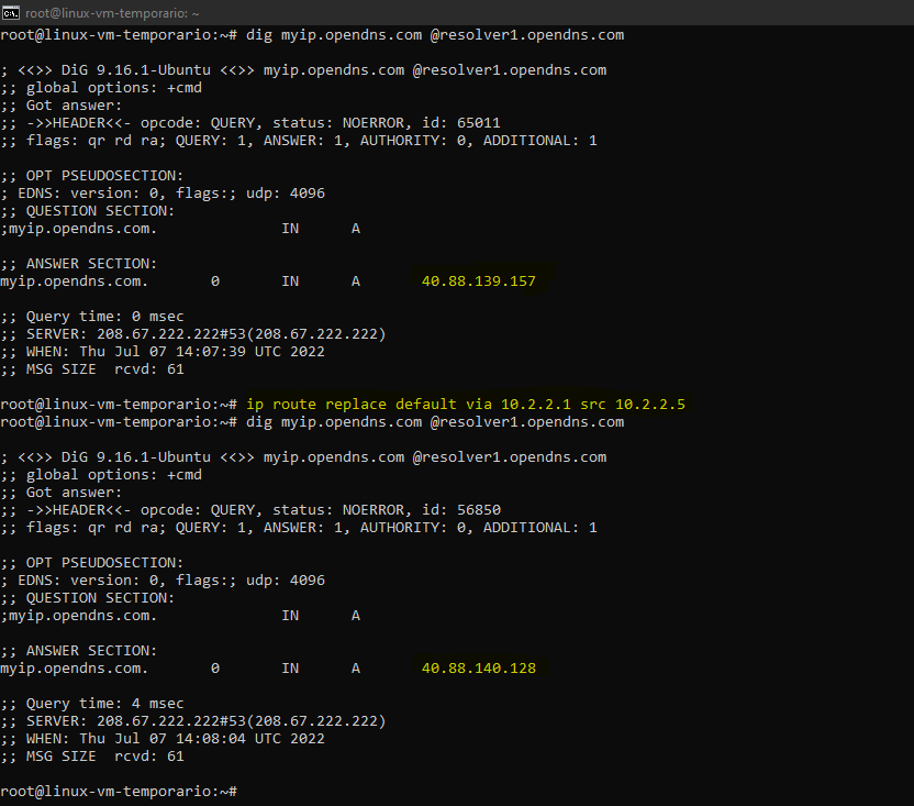

  1. Jackson Martins 10,621 Reputation points MVP Volunteer Moderator
    2022-07-07T14:11:24.953+00:00
    Hi @docter
    I see 3 possibilities
    1 - Invert the public addresses in the portal, since linux is inverting the addresses, treat it as inverted in the portal.
    2 - Change the default gateway to use the interface:
    3 - use two interfaces instead of two ips on the same interface
    In the example below, on a Azure linux machine I did the same test:
    In your case, the command just like:
    ip route replace default via 10..0.3.1 src 10.0.3.4
