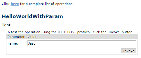

If I invoke HelloWorld, I get the expected "Hello!" back. If I invoke HelloWorldWithParam, I get the same error. Note, in case you aren't sure what I mean by "Documentation" mode is, this might spark some memories.
This issue is only when parameters are being used on the Documentation mode. If I slap on a [ScriptMethod(UseHttpGet=true)] and call via http://localhost:57067/test.asmx/HelloWorldWithParam?name=Jason I get the proper <string xmlns="http://www.lenstock.com/app">Hello Jason</string> back. Same if I write some code to connect to the web service.

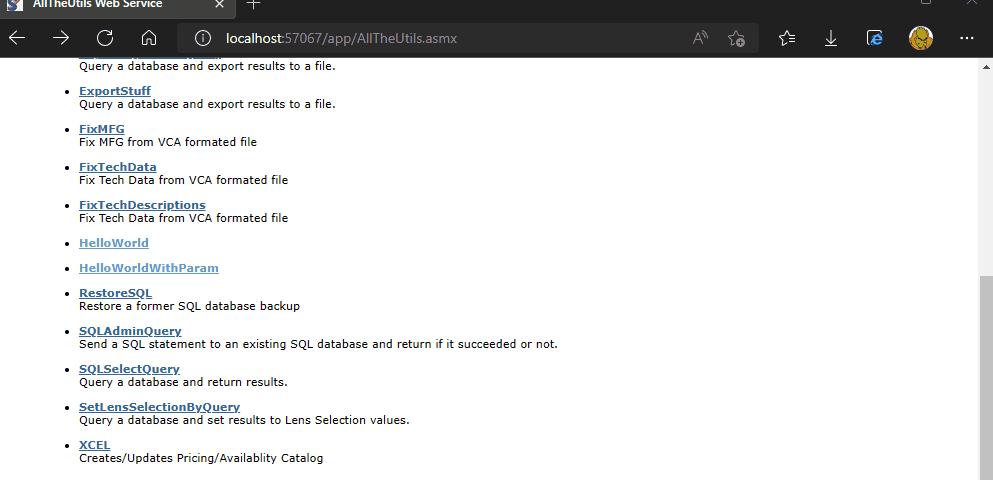

    grumbles After replying, I had a hunch.

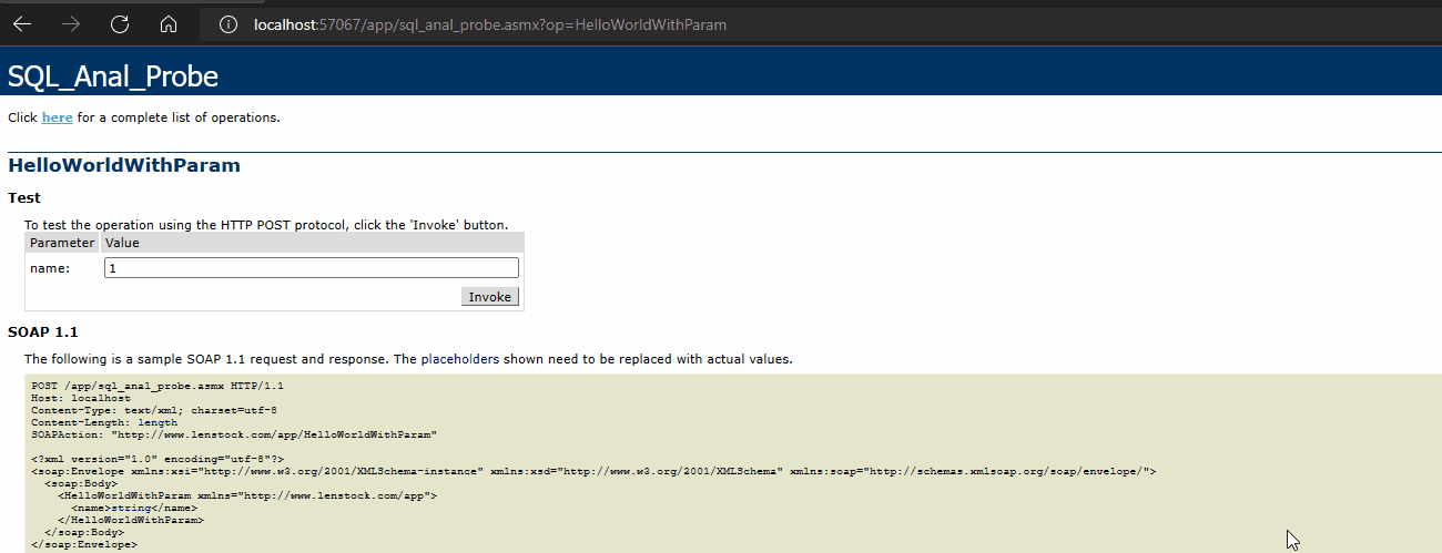

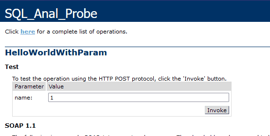

    It works correctly in Firefox. This is an Edge problem, not a VS/.NET problem.219439-workswithfirefox.gif
    I thought I'd load up developer tools to try and figure out what was going wrong and it gets even more crazy. If I do a reload on the results, it gives me the results.
