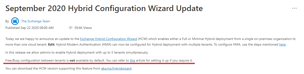

    I would suggest you migrate room mailbox to one of tenant, then do a cross-tenant free/busy sharing: September 2020 Hybrid Configuration Wizard Update
    But, if your current configuration works, you can continue to use it, although it is not supported. You could modify it when you find issue with it.
