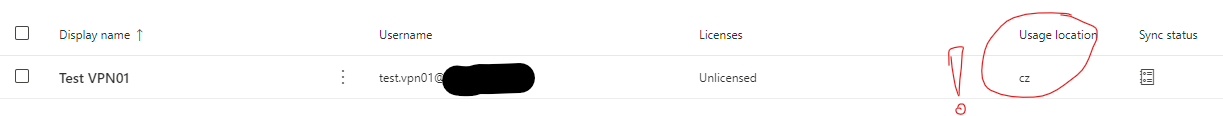

  3. I went to admin.microsoft.com to check user settings there and just to make comparison with other working accounts and I noticed that this test account has us but others have US in usage location.

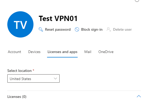

  4. I checked details of user setting in Licences and apps blade and Licence location was empty. So I selected United States and saved. Going back there but it was empty again ....

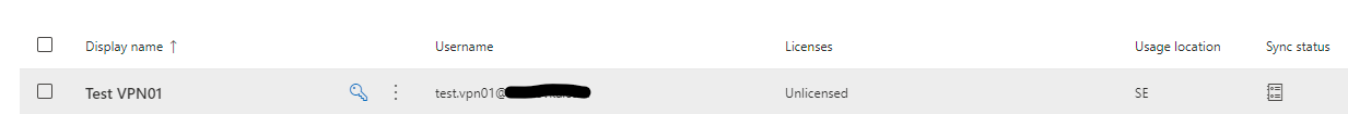

    2. When I modify user properties / Usage location in Azure AD it will modify also Usage location in Admin portal but in a wrong way! See screenshots below:

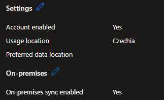

      Azure AD properties set to Czechia which should lead to CZ in Admin portal:
      But in admin portal are small letters which is wrong and makes troubles in other M365 applications -> Teams, Exchange, etc.
      And at the same time in user properties in Admin portal in Licenses and app is location completely different

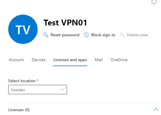

    And if I go opposite way so I set location in Admin portal it has completely different effect than when I select location in Azure AD:
    I changed user location to Sweden in Admin portal:
    But when I go to Azure AD there is nothing:
