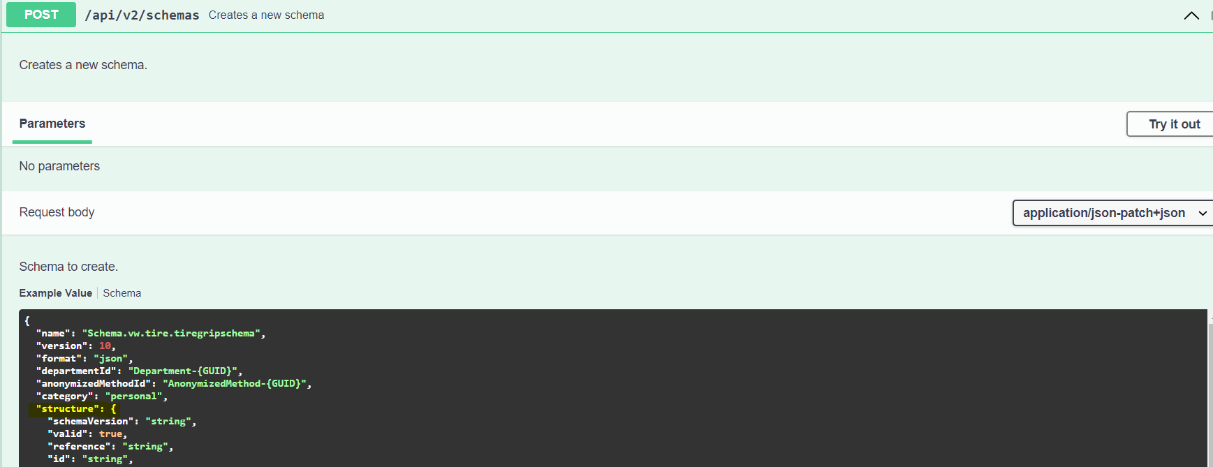

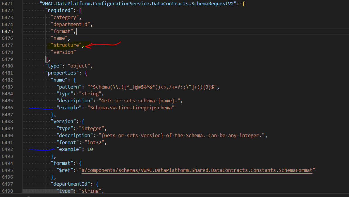

I am using NewtonSoft for my code with Swashbuckle for swagger documentation examples. When my POST has a JSchema object, in swagger it still displays fine but in APIM it's blank. for example, in the screencopy below, structure is a JSchema, which shows up fine in swagger but then in APIM, the whole request is blank! Can anyone help?

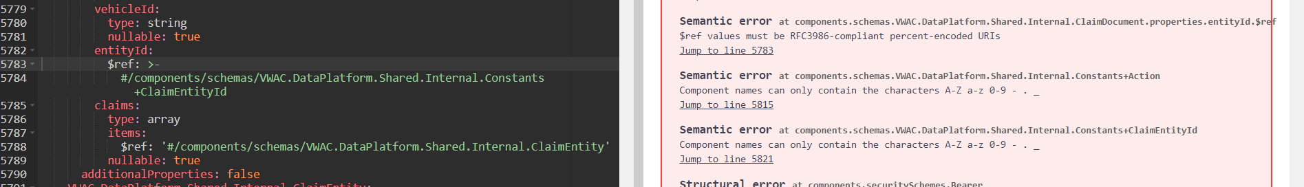

    Hi @Chu Xu Thanks for sharing the json file. I had tried validating the json file using swagger validator https://editor.swagger.io/ It initially failed with many errors as given below

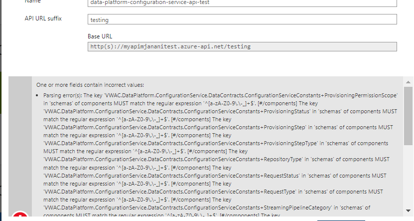

    when i tried importing in azure portal it failed with below error
    I had replaced all the "+" to "." and modified securityschemes as below it was case sensitive issue "scheme: bearer"

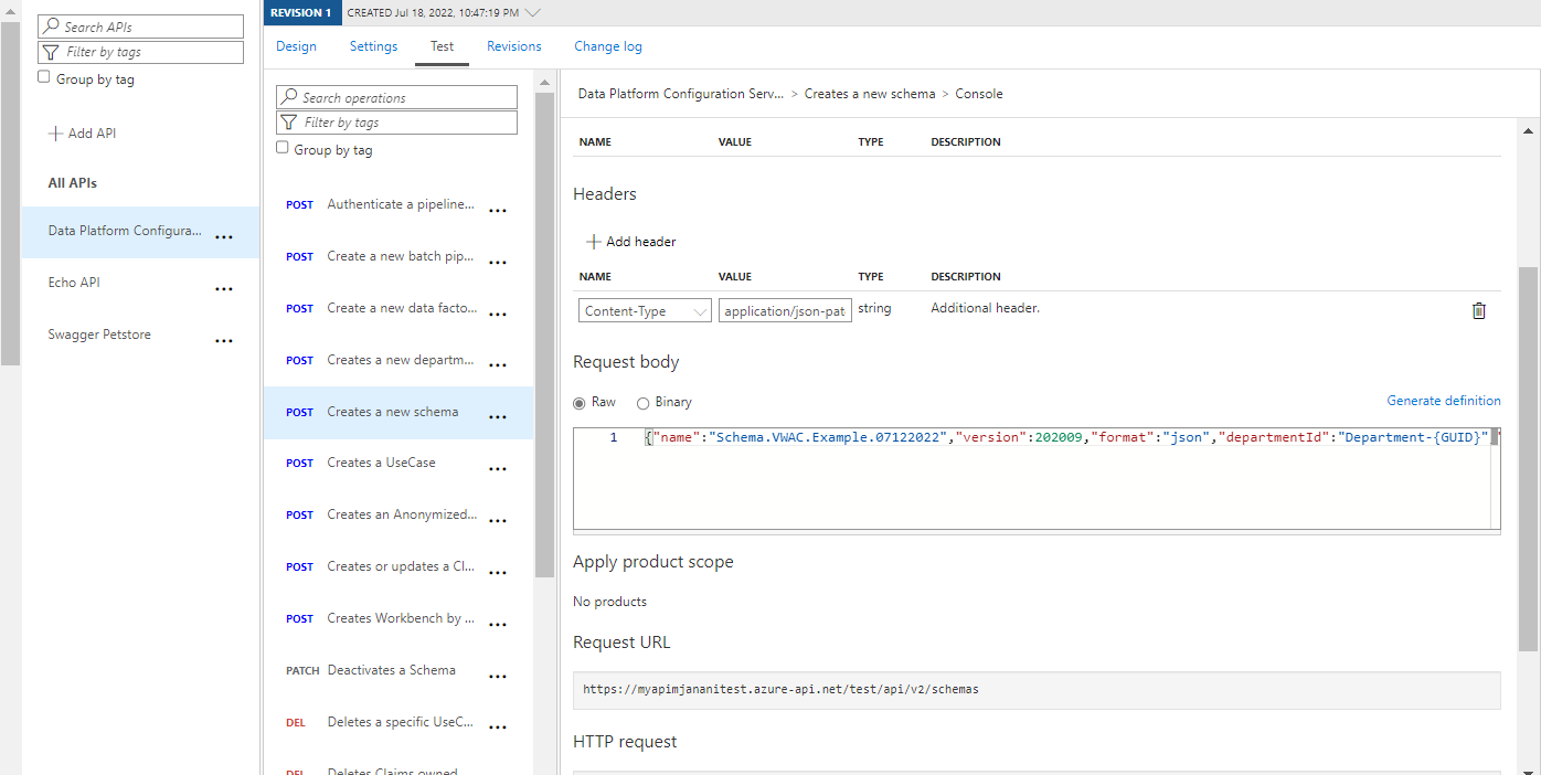

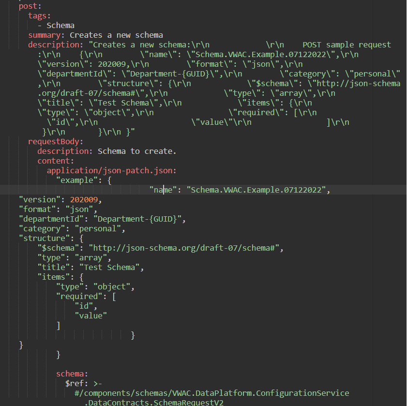

    with all these changes i was able to import the json file successfully in the azure portal. As you mentioned i was not able to see the body in test console. I tried adding the example section as below post which i was able to see the body content in the azure portal
    so to see the body content by default you need to add the example section in the swagger file please find the modified swagger.json file for schema to create 221870-finalswaggerjson-2.txt
