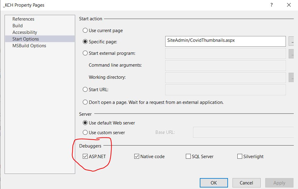

    Is your project an ASP .NET project? If so, may I ask if you have selected this option(project properties > Web > Debuggers > ASP .NET)?

  2. boB Gage 11 Reputation points
    2022-07-30T01:08:05.647+00:00
    Interesting ... last week I put in an answer to this issue, but it seems to have disappeared before I could accept my own answer.
    Anyways, to repeat:
    I dug around on the web and found a different, but similar issue that was solved by RENAMING the page (and backing object) in Visual Studio. I did that to my page, and viola -- all my breakpoints were back where they belong and working properly again.
    So yeah -- no explanation I can think of that doesn't involve bugs in environment code, but renaming COVID-19.aspx to CovidEmpPage.aspx along with the VB and JS files before the clean build finally did the trick. Clean build alone didn't do it.
