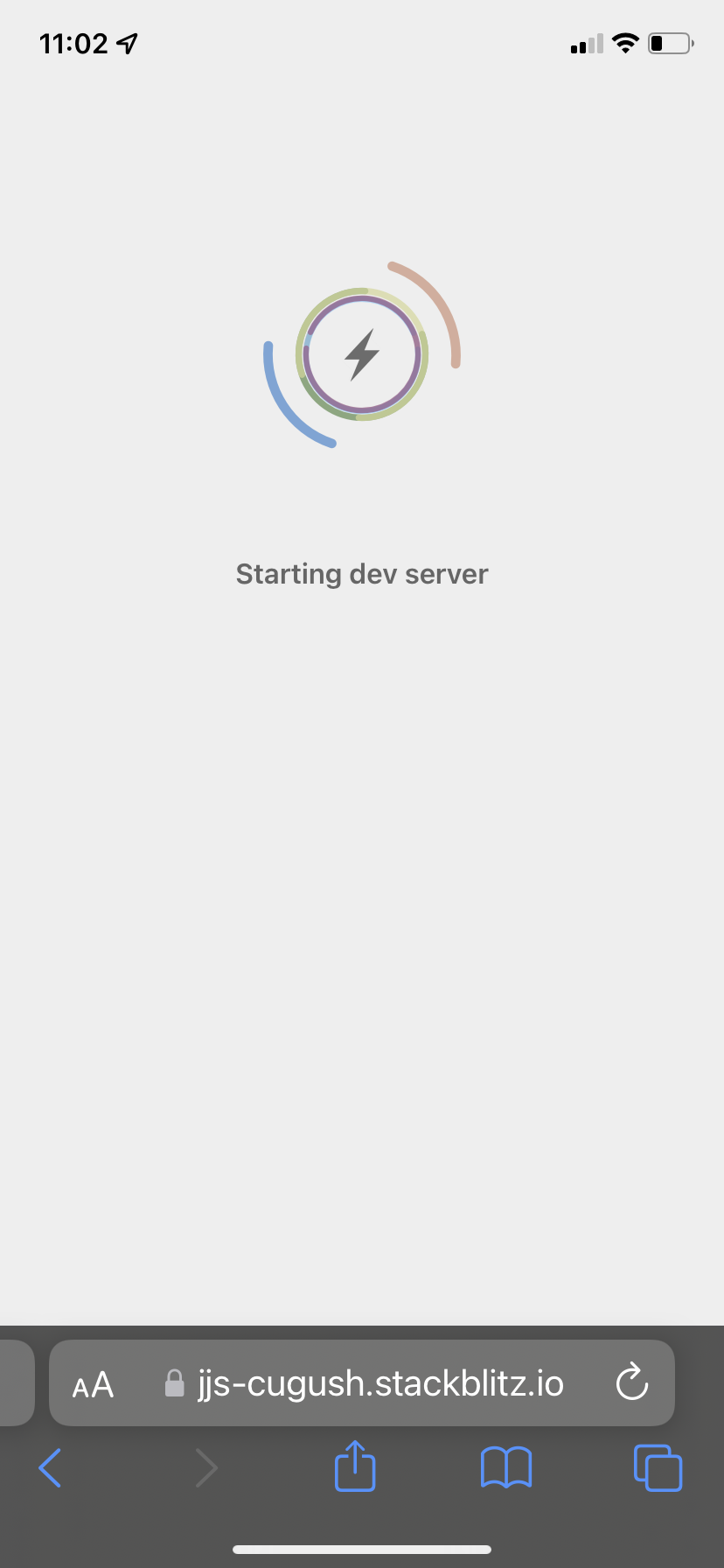

    Check this stackblitz using your original HLS and a standard <video> tag on an iPhone device.
    Application URL - https://js-cugush.stackblitz.io
    Editor stackblitz - https://stackblitz.com/edit/js-cugush?file=index.html
    iOS Safari on iPhone does not support the MediaSource API. This includes all browsers on iOS as well as apps using UIWebView and WKWebView.
    Safari browsers (iOS, iPadOS, and macOS) have built-in HLS support through the plain video "tag" source URL.
    When a platform has neither MediaSource nor native HLS support, the browser cannot play HLS.
    Find a support matrix of the MediaSource API here: https://developer.mozilla.org/en-US/docs/Web/API/MediaSource
