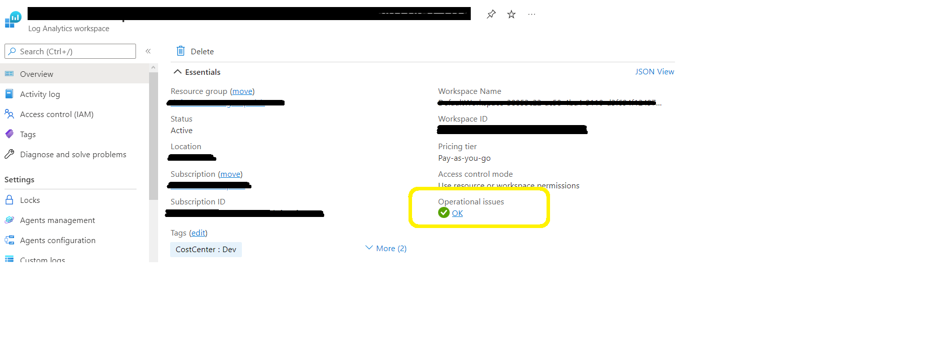

    1) Check Log analytic operation status : Refer Screen shot below , If you have OK status it means its working fine currently. If you see warning , you can explore the alert by clicking on it.

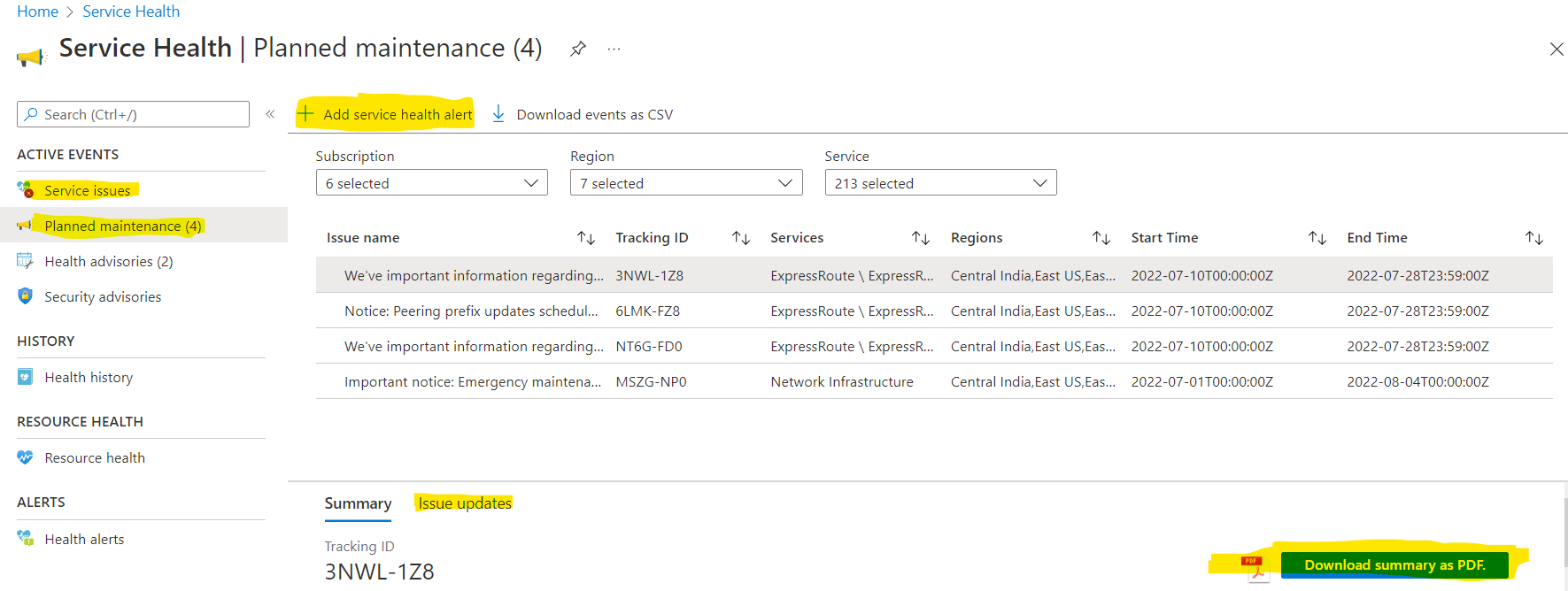

    2) Sign in to the Azure portal.
    Search for service health
    From service health menu, select Service issue
    if any service is down by MS or they planning maintenance you can check here , it can show full detail since when service is down and which region is affected.
    You can also download summary report if you scroll down and report contains which service / subscription is affected.
    You can always add service health alert critical production type workload Refer attachment
