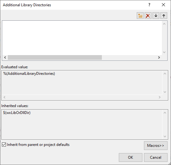

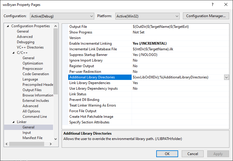

    For your hello_world_10 or wxBryan projects open the property page Configuration Properties->Linker->General and check the setting for Additional Library Directories. It should look like this -
    Click the down arrow to the right and then select "Edit". Another dialog should open that looks like this -
    Click the "Macros>>" button to expand the dialog. After it expands, you should be able to find the wxwidgets library search path as shown here -

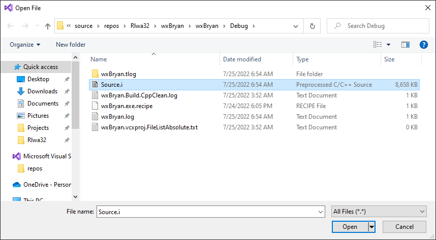

    And here is another diagnostic procedure that you can perform. For your hello_world_10 or wxBryan projects open the property page Configuration Properties->C++->Preprocessor and select the option to preprocess to a file as shown here -
    Build the project. The build should fail but a file with a .i extension should be created in the Debug folder under your project's folder as shown here -

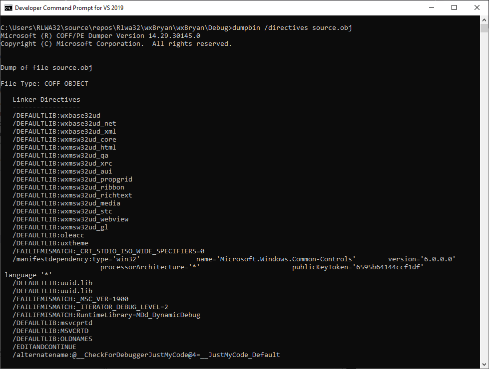

    Open the .i file in a text editor and search for #pragma comment
    You should find lines in the file that look like this for the wxwidgets lib files -
    This is how the linker is instructed to find the wxwidgets import libraries.
