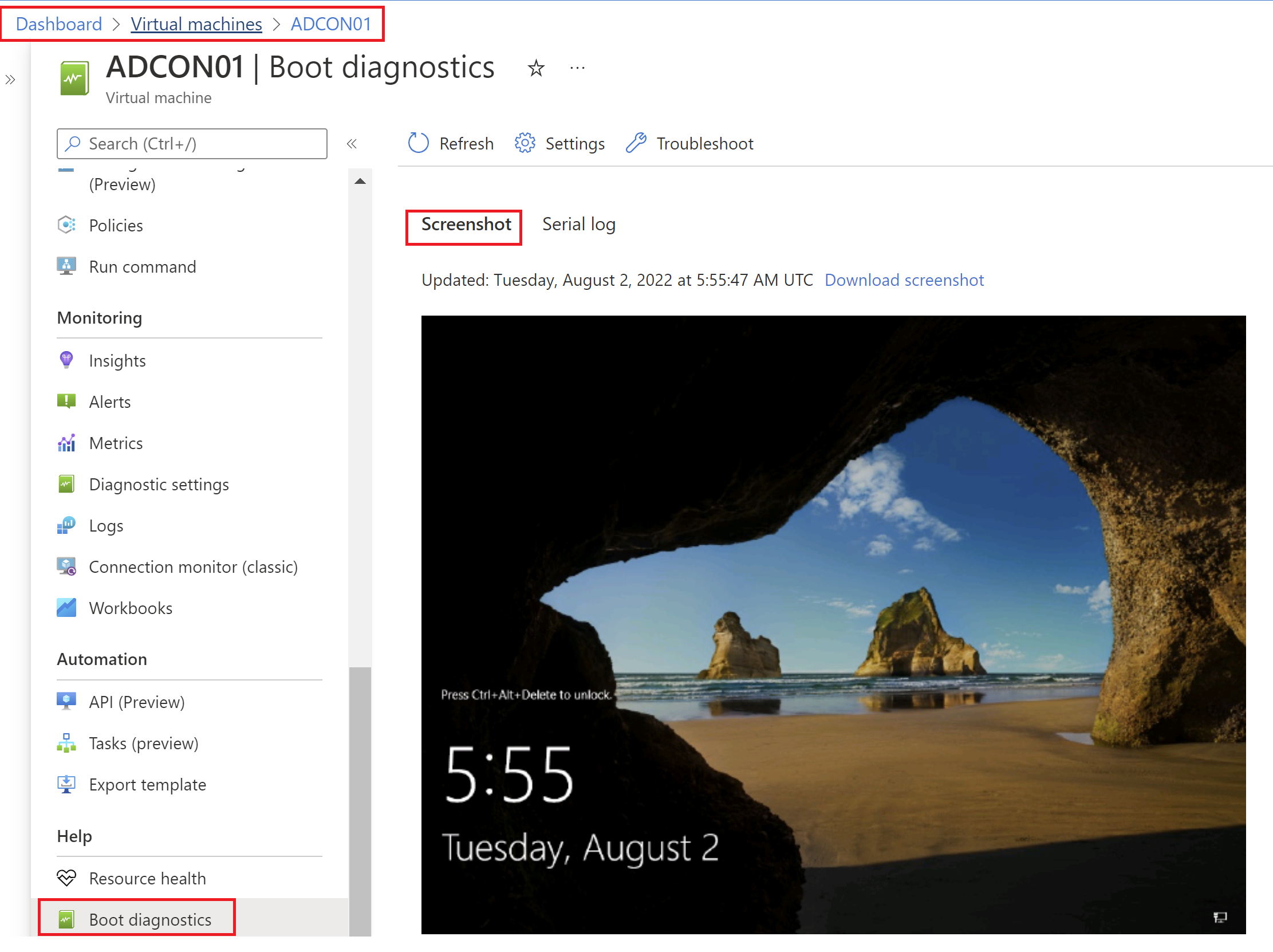

    The approach you have followed is often referred to as lift and shift method. For your issue, first thing to check whether the VM booted after it has been spun on azure using the uploaded VHDs? You can check that from the "Boot Diagnostics" blade on Azure VM as shown below (Assuming it is windows VM)
    If you don't see the login screen, then that's a boot issue. It's not an RDP issue. If you see login screen and cannot RDP, then you need to follow the TSG available at
    https://learn.microsoft.com/en-us/troubleshoot/azure/virtual-machines/troubleshoot-rdp-connection
    https://learn.microsoft.com/en-us/troubleshoot/azure/virtual-machines/detailed-troubleshoot-rdp
    It appears to be an issue with the VHD itself. To eliminate the issue with the VHD, you can try to create a VM on Hyper-V on-premises itself and see if the VM can be booted fine.
