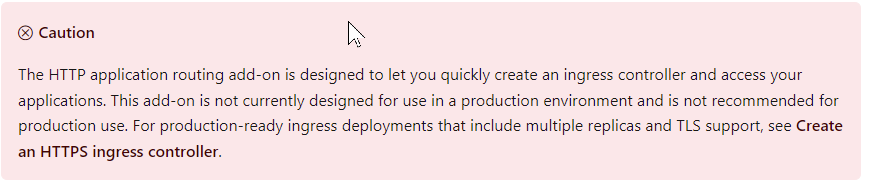

    Basically http application routing addon is not recommended for production workloads for sure:
    https://learn.microsoft.com/en-us/azure/aks/http-application-routing
    When you use AGIC enabled AKS cluster with App GW , the number of hops from the request to the application pod will less when compared to http-application-routing-addon.
    More details here: - https://learn.microsoft.com/en-us/samples/azure/azure-quickstart-templates/aks-application-gateway-ingress-controller/
