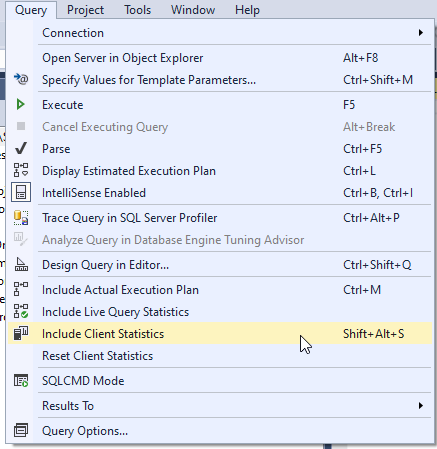

    My guess is the first query. But if you want to know it for sure, just check the performance in SSMS.
    In SSMS enable the Client Statistics and Actual Execution plan and analyse these.
