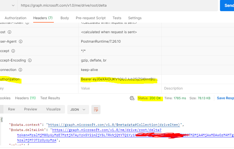

    I am attaching screenshot from Postman for your reference:
    • Without space between Bearer and token:
    • After giving space between Bearer and token:
    Similar Post: https://github.com/OneDrive/onedrive-api-docs/issues/785
    Hope this helps.
