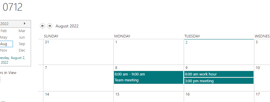

    The Event list used in the test is as follows:

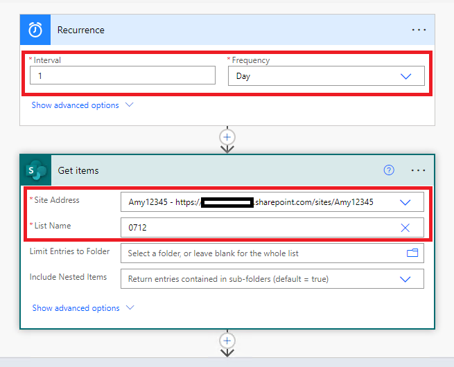

    Create a new flow: choose “Scheduled cloud flow” and set the parameters according to your actual situation.
    Fill in the judgment conditions:
    substring(item()?['EventDate'],0,10)
    is equal to
    addDays(utcNow(),7,'yyyy-MM-dd')
    NOTE: The 7 in the addDays() function means that I set a reminder 7 days in advance, you can change it to the time you want.

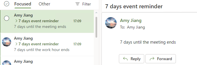

    Then run the flow and you can receive an email as below:
