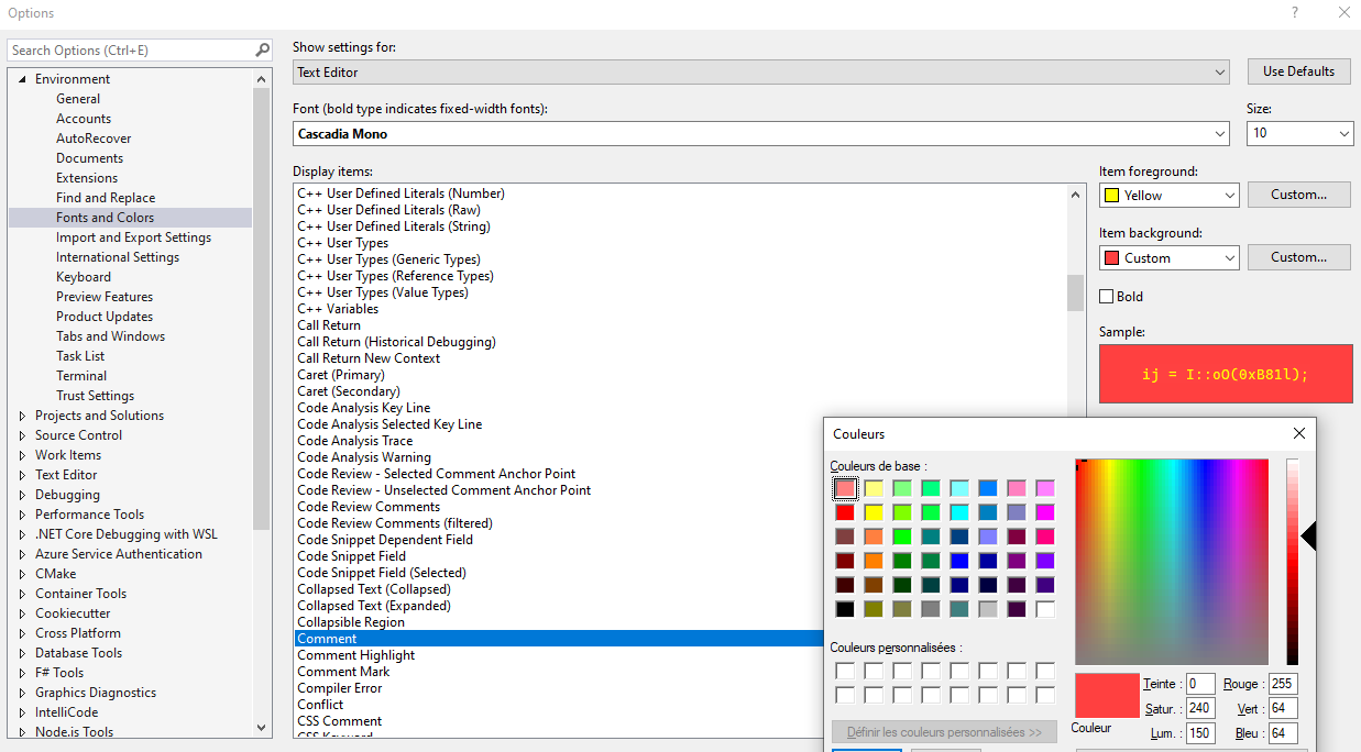

example : Comment background color specified in user fonts and colors settings : #FF4040 (255,64,64)

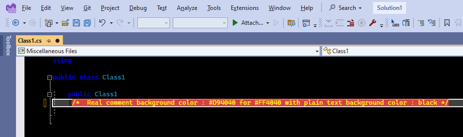

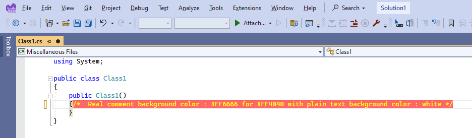

Comment background color measured with screenshot :

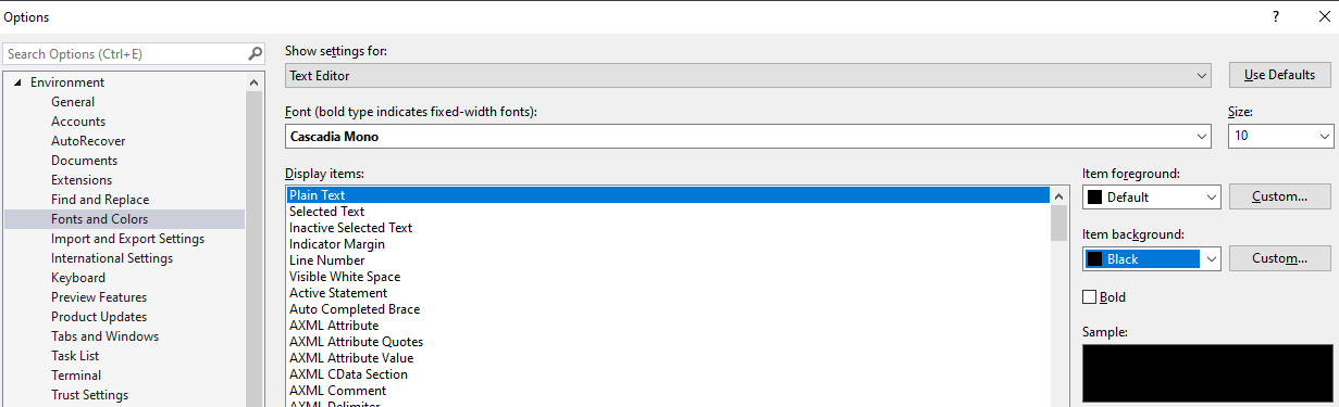

=> #D94040 (217,64,64) with plain text background color : black
=> #FF6666 (255,102,102) with plain text background color : white
