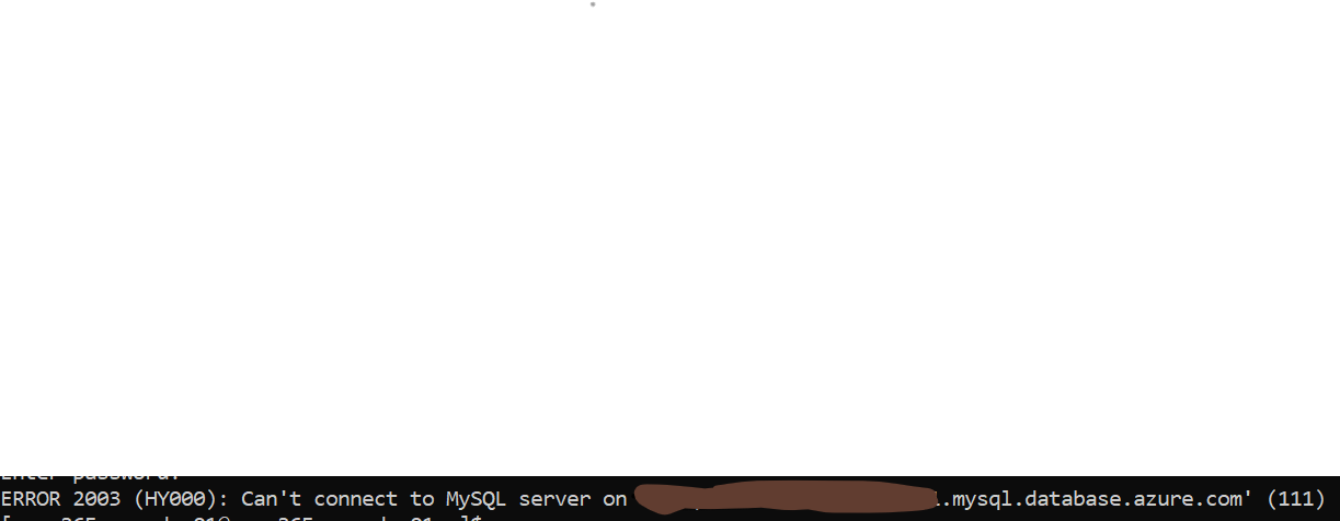

  1. Not able to connect through mysql command, getting below error- 227972-image.png

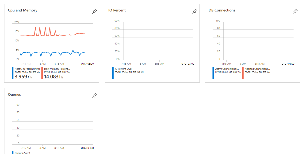

This is what I am getting on Monitoring-

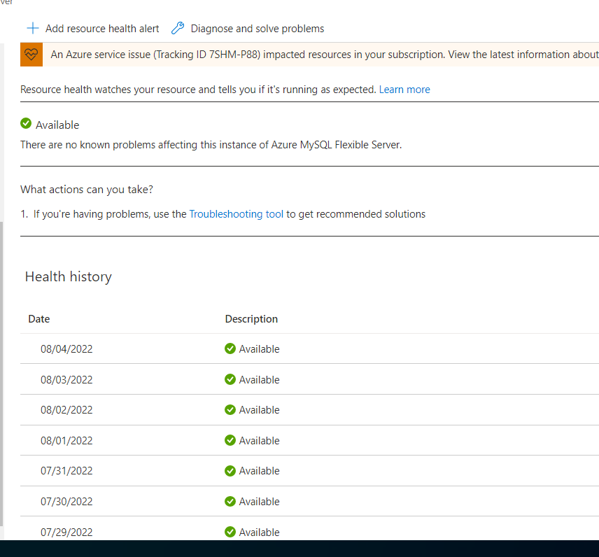

Resource health showing Available-
