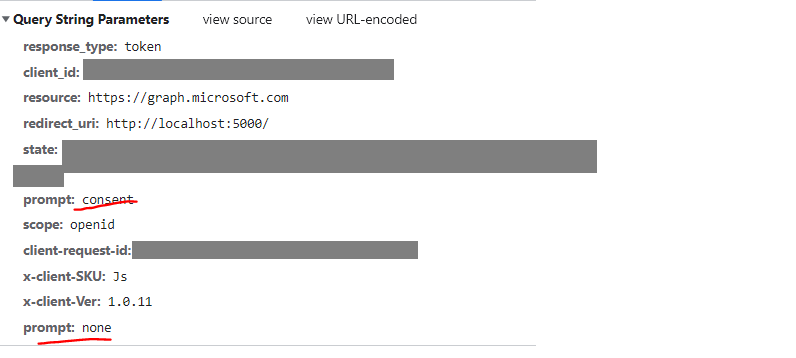

I am using adal.js for implementing the login to my app. For some reason, I cannot use admin_consent, so I am using prompt=consent in extraQueryParameter.

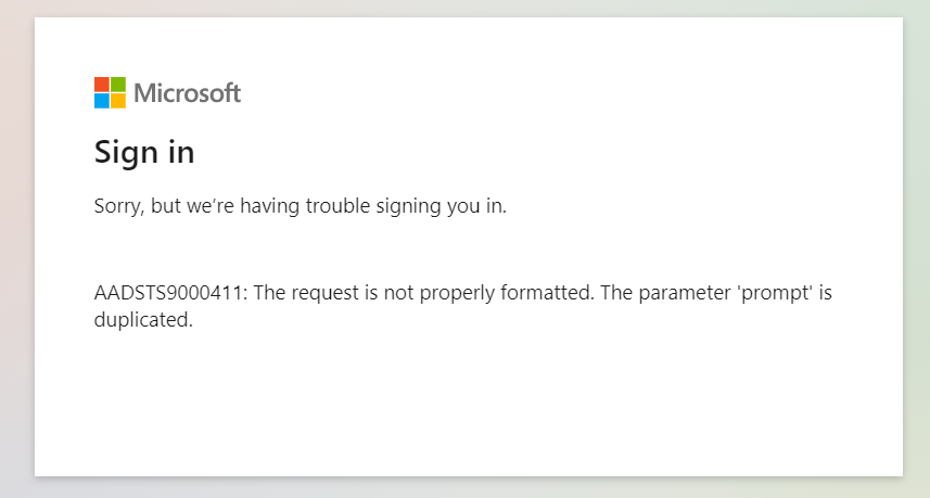

I am getting the prompt as well but after accepting the same it is giving an error
AADSTS9000411: The request is not properly formatted. The parameter 'prompt' is duplicated.
When checked the query contains 2 prompts
prompt=consent and
prompt=none
Also, i don't want to display the consent again if user has accepted once?
Can someone please help why I am getting prompt=none when I am using "consent"?
Any help would be appreciated. Screenshots attached for reference.

    Yes the URL mentioned by you is correct but response_type=id_token is what i am using.
    It displays the admin consent screens successfully to me as well & when i checked AZ portal, it does provides the consent also.
    but I am getting this error after accepting from the consent screen.
    The error is coming when I am using "prompt".
    So I used "consentType=Pricncipal" in extraQueryParameter config in place of "prompt" to give user_consent instead of admin_consent.
