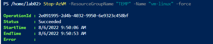

    You can update the delete behavior on an existing VM to keep os disk and try to use azure cli with force delete,
    Reference: https://learn.microsoft.com/en-us/azure/virtual-machines/delete?tabs=cli2%2Cpowershell3%2Cportal4
