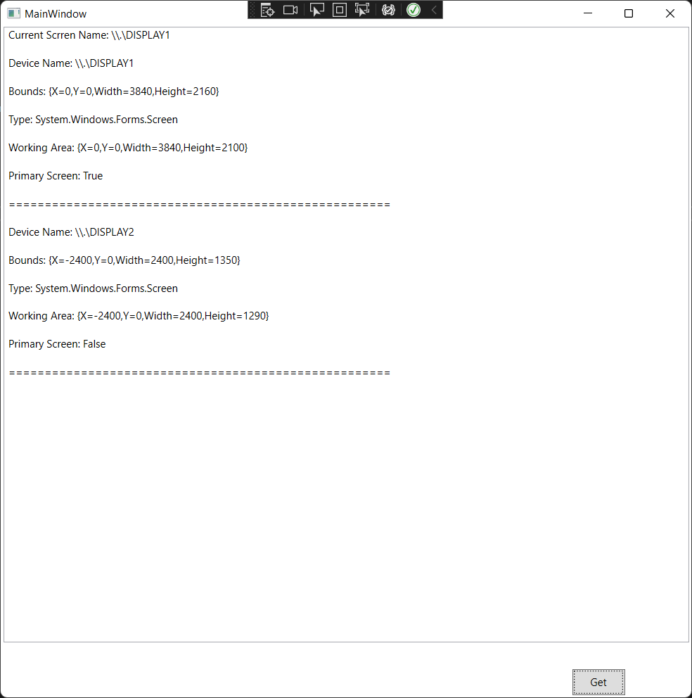

    I made a sample:
    CS Code:

    Run result:
    DISPLAY 1:
    DISPLAY 2:
