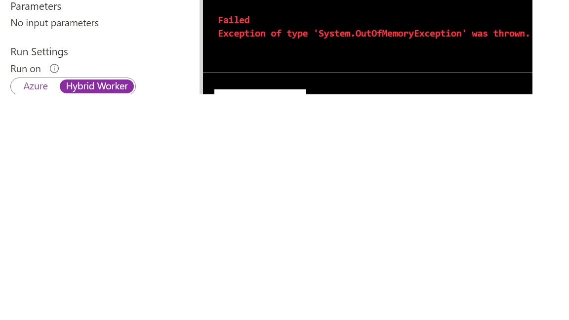

I'm working on making a rest api call which pulls back data from the year 2000 until the current year when I run the powershell script from my machine everything works as expected. If I were to run the azure automation runbook I get out of memory exception is there anything I should be doing to make this work. I'm looping on this rest endpoint for each year starting from the year 2000.

  1. Maxim Sergeev 6,586 Reputation points Microsoft Employee
    2022-08-08T16:07:31.947+00:00
    In this case you need changing the following settings in your Hybrid Worker Severs locally
    $PSHome
    Install-PowerShellRemoting.ps1
    net stop winrm
    net start winrm
    Get-Item -Path WSMan:localhost\Shell\MaxMemoryPerShellMB
    Set-Item -Path WSMan:localhost\Shell\MaxMemoryPerShellMB -Value "SET WHAT YOU NEED"
