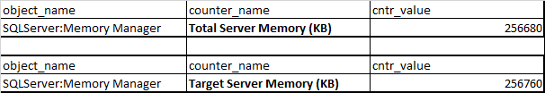

Buffer Cache Hit Ratio is 100

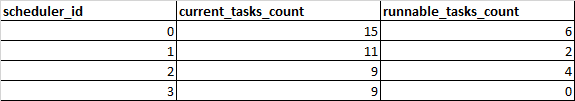

CPU Pressure from sys.dm_os_schedulers:
SQL Server | Other

    Mostly Sql, WMI provider host and 3rd party tool application
    My Total Server Memory and Target Server Memory are close so no Memory Pressure, right?
  4. Erland Sommarskog 128.9K Reputation points MVP Volunteer Moderator
    2020-09-15T21:42:40.737+00:00
    Seems more like internal memory pressure to me. 8 GB in total is not a lot...
