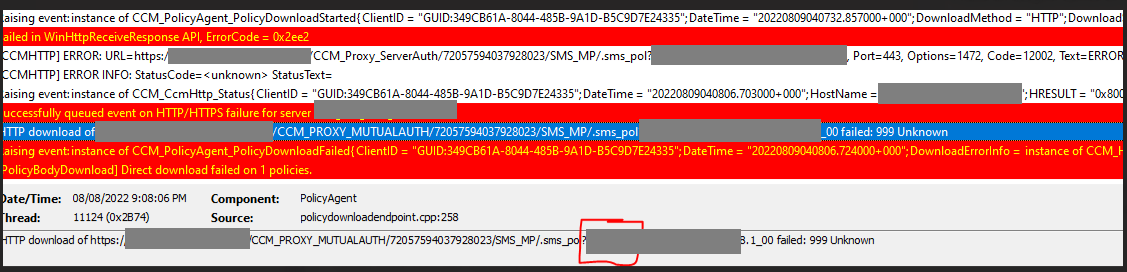

Does ConfigMgr require HTTPs (eg PKI cert) on Cloud only AADJ devices (configured with CoManagement) in order to run a Task Sequence when the device is internet facing?
I have a site that preferences PKI when available but the device was using a SelfSigned cert. All apps and program deployments targeted at the device ran fine from the Internet/CMG but the Task Sequence would NOT even show up in SW Center.
As soon as i changed the client to PKI it showed up immediately.

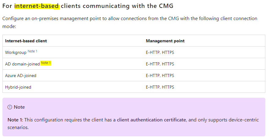

MS Docs is a little vague. Is Note1 in the graphic below fulfilled by a SelfSigned cert? And if not then why to pkg/apps work...does MS Docs need to be updated?
PolicyAgent.log output below where it tries/fails on HTTP/S.

    "it's not you it's me"...complete CTKE and shot to my ego, but i will still mention it here for others' sake.
    I used PolicySpy which was showing the deployment HAD been received and the only reason it wasn't showing in SW Center was because the local client timezone was 12hrs hours behind the time the TSeq deployment was created (as it was set in a diff timezone).
    Hence it does show up on the client 12hrs later (or if i bring the deployment available time forward).
