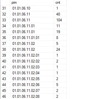

Sample Output: 230585-sample.jpg

  1. Bryan 21 Reputation points
    2022-08-12T13:02:58.707+00:00
    Thank you Erland.
    I think I need to think of a different solution though. My query, and yours, return rows with duplicate PIMNumbers.
    From the query:
    pim - cnt
    1. 01 - 34
    2. 01 - 596
    Both of those are correct, in a sense. There are 34 that exactly match 01.01. There are 596 that are like 01.01%. All I need is the 596 value. I'd like to take all these values, export it to json, then put it in a tree map so that you can then drill down and see how many customers are at each level. I'll have to look into our charting program to see if it can query as you drill down through the tree map instead of supplying it with all the data up front.
