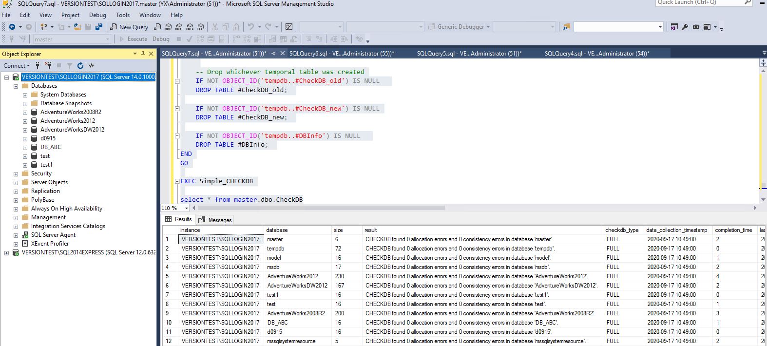

  5. m 4,276 Reputation points
    2020-09-17T02:57:54.507+00:00
    Hi @zoe Ohara ,
    Code from this doc. will be helpful: simple-dbcc-checkdb-process-to-report-on-database-corruption-for-all-sql-server-databases

    EXEC Simple_CHECKDB
    select * from master.dbo.CheckDB
    BR,
    Mia
