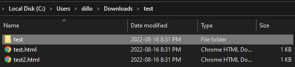

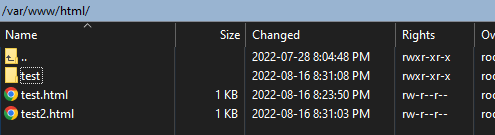

    Example
    What's on my server (via WinSCP):
    What was downloaded with the script (locally):
