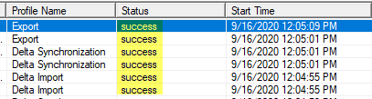

On the server, the Synchronization Service Manager shows success for all sync operations and they are executing on a schedule (Delta Import, Delta Sync, & Export.) [Full instead of delta also shows "success'.] Manually executing/running the connections from the connectors tab also shows "success".

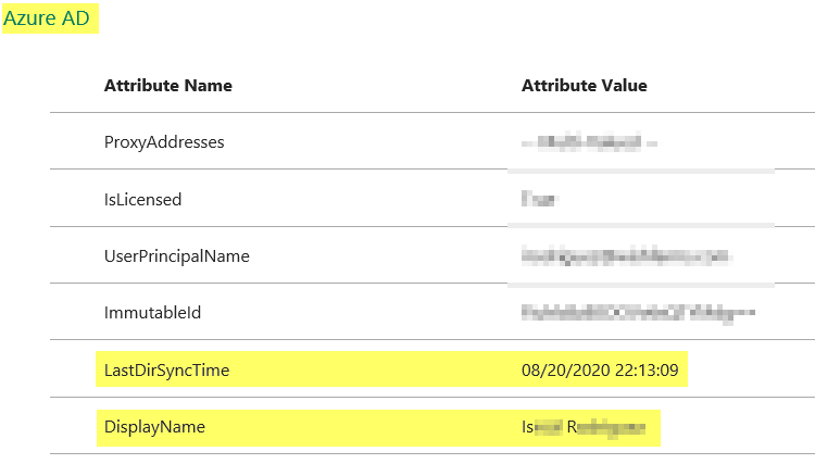

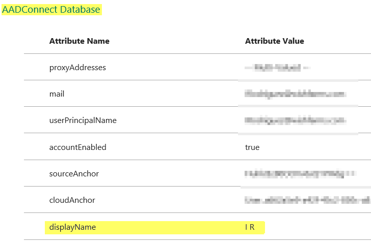

  • When I run the troubleshooter powershell script and using the "Diagnose object synchronization issues", I can get the diagnostic report that shows the "On-Premises Active Directory" & "AADConnect Database" with the same values, but the "Azure AD" object is showing that it has been several weeks according to the LastDirSyncTime value. We made a changes to a user's display name yesterday, which should have caused a sync/change, but that sync time hasn't changed and the display name doesn't match, see the pictures below. (The AADConnect Database sourceAnchor value matches the Azure AD ImmutableId.)

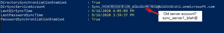

  • Used the Get-MsolCompanyInformation powershell command and it shows a LastDirSyncTime/LastPasswordSyncTime that is recent from today. Interestingly enough, the account that is shown here doesn't exist in our AAD anymore. It has the format of the old server name, not the new one.

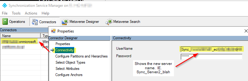

  • Confirmed the connector for Azure AD was set to use the correct user showing the new server name and confirmed that that new user exists in the Azure portal.

    Dumb question. Are sure that some other AADConnect server is not still syncing? Is there more than one AADConnect server here in the mix? Do the Azure Sign Logs show logins for that old account Sync_ ?
