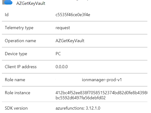

During the execution, Function App failed to access the Secrets stored within the Key Vault with the exception copied below.
Below is the copied source code used to access the secrets from the Function App.

Unfortunately, during the debugging process function app uses my identity, works as expected and throws no exceptions. After publishing the function app, the exception mentioned above is thrown, which is time-consuming to troubleshoot.
