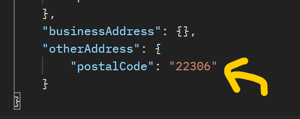

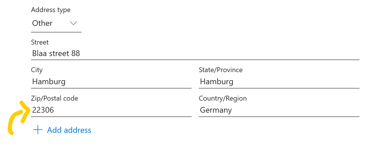

When I make changes to any attributes of an address on the Outlook people website, and then retrieve that contact through the API, it only shows the updated attribute of the physicaladdress. However, it should show the entire address. As you can see in the screenshots, I only changed the ZIP code, but when I call that contact, it only shows the updated attribute of the address. Can someone please help? Is there any way to report this? Our integration with Outlook is currently stuck due to this issue.

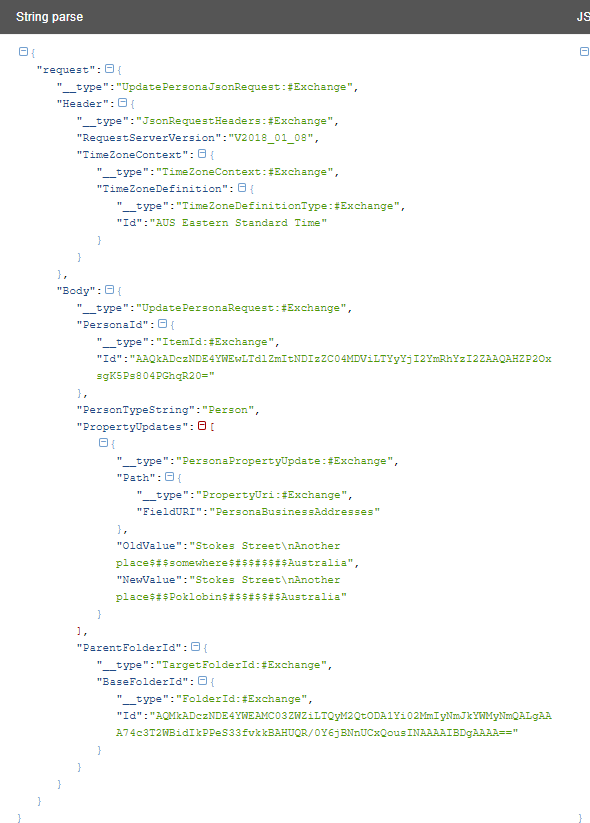

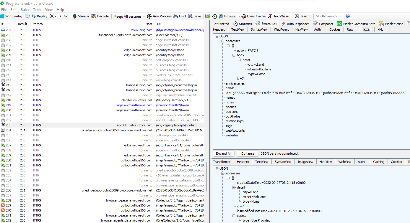

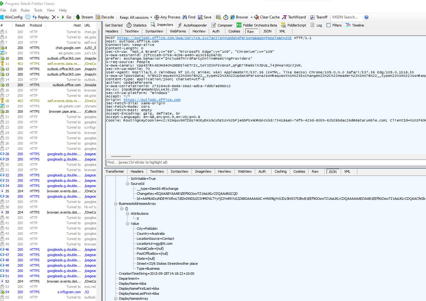

    @AtulThorat-MSFT you need to test this by doing a patch on an existing contact eg
    What is happening is when you update one property in the collection it's deleting all the other existing properties in the address collection which shouldn't really happen so it's either a bug or something that needs to be documented.
