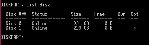

I tried to delete the driver, reboot and nothing happens. Also, the search for hardware changes and check to see if the there is a current drives is not working. As a last resort I enter into diskpart:
However, the disk still does not appear. What can I do in this situation? Is it that the drive is dead? It is the first time that it happens to me with a Seagate drive, I have another one of 2 TB and it has like 4 years and is still working.
