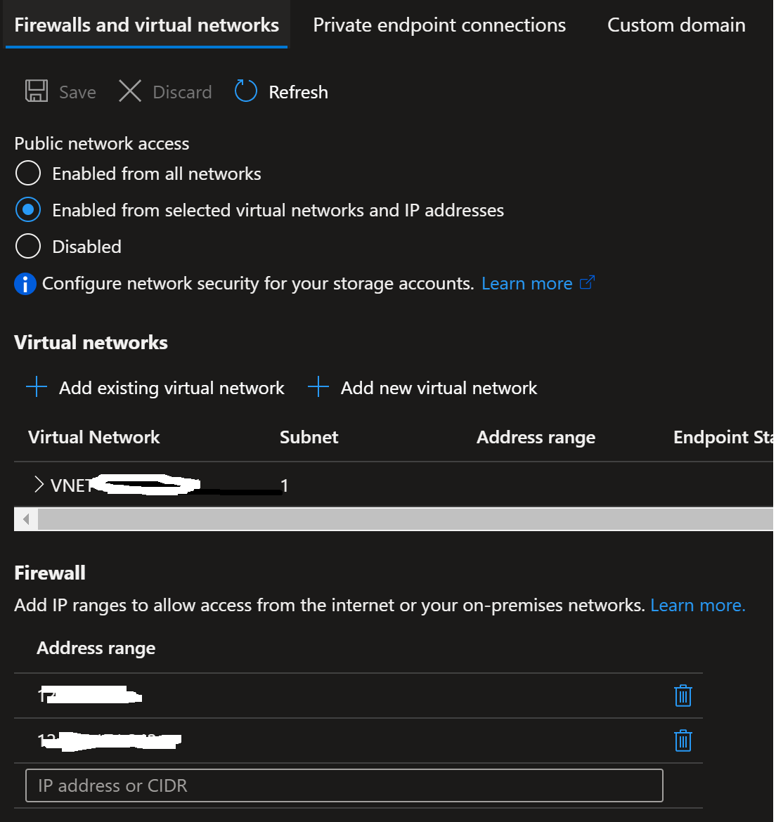

I am having issues accessing the containers via the azure portal when I enabled below:
Enabled from selected virtual networks and IP addresses
My objective is to be able to restrict storage access within the vNet but I should be able to browse it via portal and storage explorer.
Take note that I have added my IP address

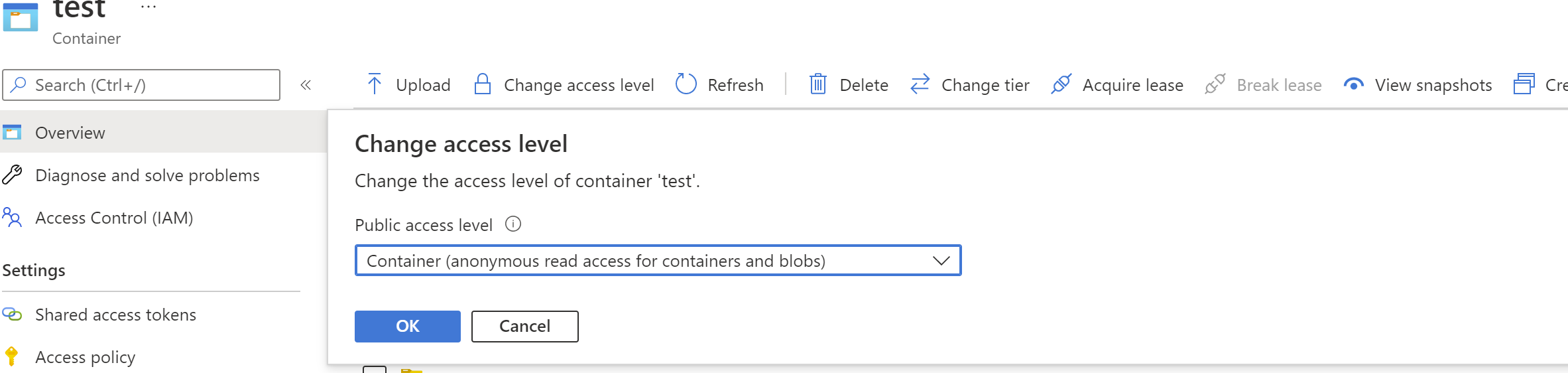

    take note that im getting this error when I access a new blob.. .same with queues
  2. JoelP 386 Reputation points
    2022-10-28T03:29:25.887+00:00
    Just an update... the issue was on our proxy.... so we had to add core.windows.net in our proxy whitelist...
