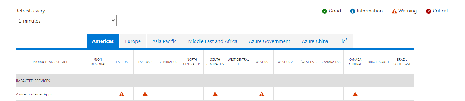

    It is also possible that the ability to launch container instances is impacted by the ongoing service outage. You can read about this issue on our status page.
    https://status.azure.com/en-us/status/

    Thank you @deherman-MSFT for this information.
    I will continue to monitor the Azure services status page and try the deployment at a later time. I'm afraid those are our only viable options at the moment.
