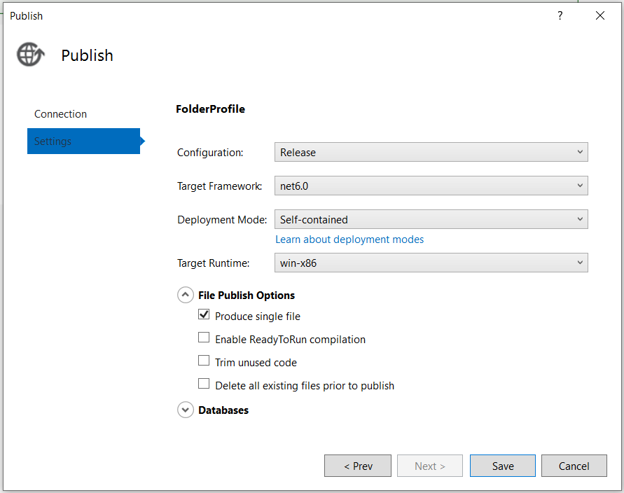

  2. Dennis Tabako 1 Reputation point
    2022-09-01T18:14:31.27+00:00
    OK, it turns out what I needed to do was publish as a single executable:
    Notice the "Deployment Mode: Self-contained" choice and "Produce single file" checked. After publishing that way, I only had to add the executable (no other files) to my Wix manifest and the generated installer worked fine. I'm guessing I was missing a dependency somewhere that I didn't know about. But it's weird that I was able to install and start the service from the same publish directory as I was trying previously with Wix via sc.exe. Anyway, it works now. I went back to the official MS page for creating a Windows service in ASP.NET Core 6, which I read a little more carefully this time and found the little blurb about this being recommended.
